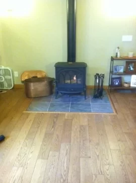

    We finally decided on a unit. I purchased a Jotul F400 and it will be installed 10/17/2013. It will be sitting on a pad 65"x48" made with natural copper slate. I can't hardly wait to fire the stove up. I'll post a picture post install. Thank you for all of you advise/help.
  22. begreen
    begreen
    Mooderator 2.
    Staff Member
    Nov 18, 2005
    68,127
    9,562
    South Puget Sound, WA
    Congratulations. That is a beautiful looking stove. Note that it likes a strong draft. Make the chimney as tall as possible. Other than that the main issue this first season will be having dry wood. Do you have a good source?
