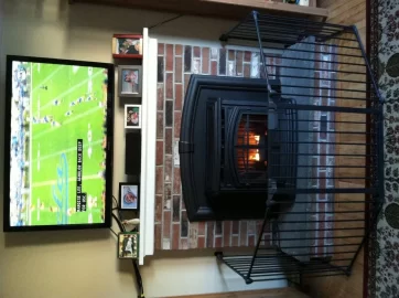

    The guys from Cedar Mountain Stoves came by today and installed my insert. The installers were very friendly, and they did a great job. I had the OAK installed. The stove looks super nice. I'm trying to burn off the new stove smell, so I have it on level 3. The windows are open, and its 74 in here. Right now I'm burning a bag of pellets the installers brought. I'll be breaking out the EasyBlaze next.

    Very nice. I'd crank it up to 5 for a few hours now with the windows open or you'll be smelling it again when it gets colder out and you bump up the heat. Congrats!

    Nice looking set up. You and I have similiar climate and the same stove. Check out some of my recent posts on settings and such. Enjoy it.

    + 1. Full tilt till you can't smell anything.

    Hope you didnt pay the instalers. They put the stove in sideways.:). Looks great, youll love the stove. I had my dealer pre burn my stove before he delivered it

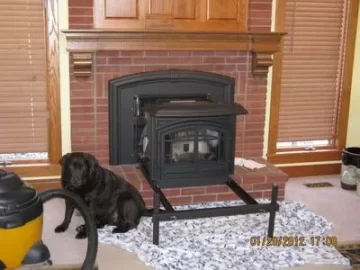

    Did any of you guys with the M55 Cast Insert install the optional Service Rails? Would you advise using these?

    Service rails are awesome! Happy Turkey Day to you and your family as well!

    I agree on the burn-in suggestions,... run er up on high now, or you'll get the smell later in the season when you dont want it.

    Nice looking install Eatonpcat!! I think I will suggest the service rails to my friend for the M55 insert.

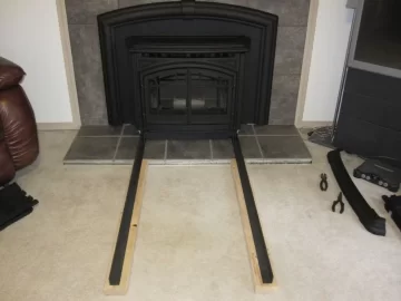

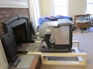

    I made my own service rails out of some angle iron and a 2x4. Cost me about $10. I lucked out in that the 2x4 was the perfect thickness to match up to my hearth...
