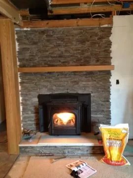

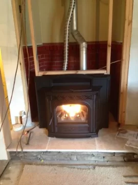

[Hearth.com] NEW INSTALL Has anyone seen an Oak installed directly inside pipe alongside exhaust? Wanted it done because will have limited access to it, yet installer didn't want to do it at first. but wasn't taking the chance because of access
admitted newbie here
If the top pic shows what you are questioning about your install, there is absolutely nothing wrong that I can see.
Where does the OAK teminate?
Goes approx. 6 feet into existing (previous wood stove pipe) Thank you, I thought it might vent out the side wall on its own. mantle going up tonight , then finishing stone soon after
Either way is acceptable. Your install looks sweet!

I think a lot of people run their OAK out the back of the chase, in your case, just above the brick. If it's terminated up on the roof, you may have problems with snow. How long is that OAK pipe? Is that 4" venting with 3" OAK pipe?
Ahhhh, I see. Good idea utilizing the old pipe for the OAK:) That's gonna look sweet when it's done.

I live in a split level home, fired it up 28 degree night(located on first level) , maintained surprisingly even heat
upstairs (75 degrees downstairs , 72 upstairs ) very pleased with its perfomance

Thanks, reading the forum I see many installers don't want to install an OAK, had to convince them to do it even though was paid for (wanted to refund) in my case wanted to be safe than sorry

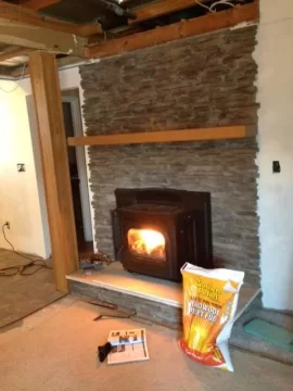

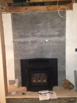

That wood frame right on the stove chassis doesn't scare anyone else?
Reactions: PELLETCONVERT
Hello Brian , was a concern for me as well , was raised before installing cement board, also using a zero clearance box from Harmon
Good point. I assumed the Harman ZC box was used in this install & is hidden behind the framing...
Ah, yeah, the zc kit should make that fine then.
You are correct in your assumption:)
Of course we want pics when its finished! :)
Nice install and glad to see the manual at the ready;lol Surge protector on there too?
Is that the standard size accentra or the 52i? Looks good!
Very nice, only thing left to do is correct the spelling of HarmAn in your signature... Sorry, just can't help myself...
Thanks all!, Standard Accentra insert, with surge protection==c

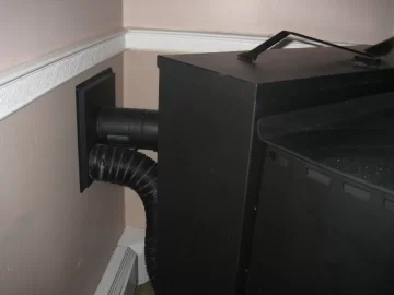

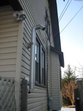

here's our install.. Harman P 61A
[OAK spray painted black to match....it's an Organization issue..lol
