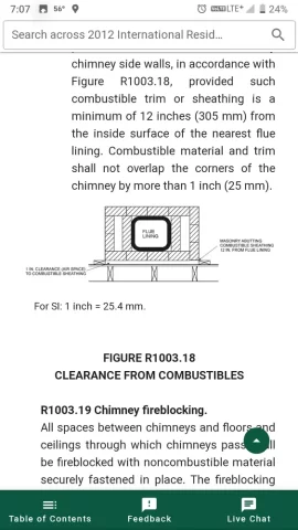

They also didn't install insulation around the flex which I am reading is mandatory.
Required by code if the chimney doesn't have 2" clearance from combustibles (interior) or 1" (exterior). It's an added cost. This is frequently skipped to keep the bid competitive.
My install is probably not required by code here then, I couldn't confirm it in the Arkansas building codes. They are going to have to pull the liner to clean anyways. I'll pay for them to add it. No combustibles, I have a clay lined chimney but it has plenty of room for the insulation.
The clearance to combustibles is from the outside of the masonry structure
Here is the code
