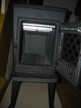

Dear users,
my new jotul 602 has been just delivered.
I noticed the following:
at the bottom the two base plates parts overlap a bit, is that normal?
please see the pic.
I really hope it's okay...
Thanks for your advice.
Pavel from Holland

My old unit has a single base plate so I can't check, but I would expect them to lay flat. Maybe it moved during shipping? Have you tried tapping the left side one over with a wood block?
Remove the two side plates, realign the bottoms so they butt against each other, and replace the side plates. Problem solved.
hey pavel
got my 602 in nov,side plate was ajar,just slid it in,so i imagine you can slide your plates out and re-align your base plates.check your door latch as well,mine is bent out farther than vertical,seems yours looks like that as well,other that that this little box heats like heck,and burn times are much longer than you may have been led to believe....cheers
rod
hey guys,
I did as you said, now everything seems to be okay,
i must admit this little Jotul is the best purchase i've made in years,
i'm really pleased, although it hasn't been installed yet
