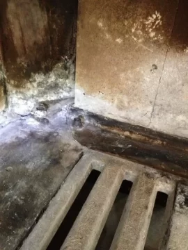

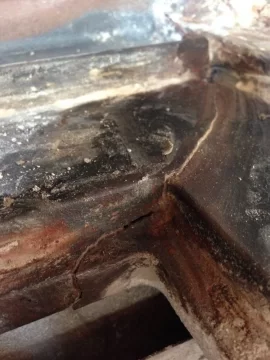

What do I look for on the castings? Does anyone have a photo tutorial of stove defects to look for?
Here are a couple photos of cracked bases due to using the ash pan door as an air supply.

I wouldn't recommend going down this path if you do not already know what to look for.
Many of these stoves have been damaged by overfiring caused by leaving the ash drawer door (say that 3 times fast...) open too long when starting the stove up. 12 years (minimum) is a big window for a mistake like this to happen.
If you do go ahead and take a look, be prepared to spend some time and go over every square inch of the stove carefully with a very bright light looking carefully for cracks in the cast iron. Once you have done this on the outside of the stove (including underneath the stove and in back of the stove), open the firebox and do this on the inside of the stove, inch by inch by inch, paying special attention to the bottom plate. Now remove the bolt at the rear of the stove that holds the cat flame deflector. Inspect the deflector for cracks, pull the cat out and inspect the area behind it and the cat itself. Now open the ash pan door, pull the pan out and inspect that area of the stove. Next, check the operation of the footpedal assembly and the manual damper assembly located on the upper right hand side and operated with the wooden handled hex wrench. I would probably spend an hour doing this, and I'm familiar with the stove!

...and don't forget to look carefully for areas where the rebuilder may have tried to use stove cement and paint to hide those cracks!

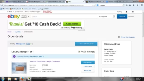

Going on the 7th season running my model #12 cat. -( original post of the best craigs list i ever found) Just ordered a new back-plate, and a new Jotul CAT (steel binding) - Do Not Use the Condar replacement for the model 12, in this model they expand and take out your refractory shelf that holds the cat in place. Cant speak for the other models they fit. Anyway, doing a full rebuild this year after 6 years of about 3 to 4 chords per year of moderately seasoned hard wood. I found a supplier for refractory ceramic fiber board on line that I am crafting a new shelf out of for my cat.

Where did you buy your Jotul cat, and what did you pay? Learned my lesson the hard way with Condar, on two chambers in two stoves, one brandy new.
Ebay! $119.00.
http://www.ebay.com/usr/lklick4goods
To be seen if it is a good deal. The seller has mixed reviews, but I figured I would take a chance.
Hard to find the jotul cats except through the dealers for top dollar.
That stinks about your chambers!!! Thats an expensive "oh sh#t moment"!
