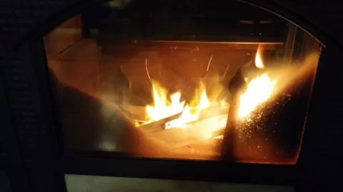

It'll do that sometimes. I guess the heat of the cat ignites the smoke inside the screen. Probably a little early to say for sure, but any impressions on weather it's tossing more heat than the 2461? Mine definitely beats my 2460, but the Dutchwest comes a little closer when I have the blower running.Here's a pic showing the flame just inside of that cage

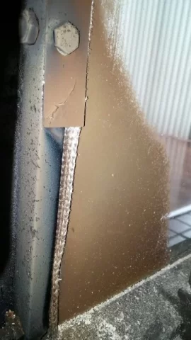

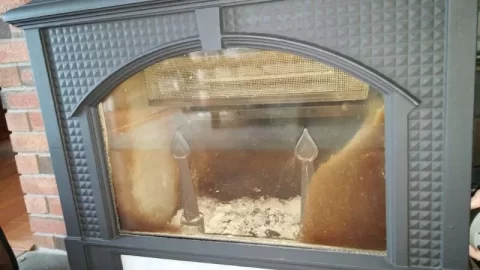

I wouldn't think you should be seeing that much on the glass, the way you're burning. Check the glass gasket clips, might have to tighten them a little...don't overdo it. But like Joful said, probably just got into some damp wood.How normal is it for the glass to get blackened like this? I know it's only been a couple days of burning but I'm burning dry wood at hot temps
I think what happens is that the glass gets cooled, allowing creo to condense there.If you have a door gasket leak, you'll sometimes get a partial staining of the glass. I honestly don't know why, as it's counter-intuitive

Some types of wood just seem to haze my glass a little more. I've noticed that with Oak, but not sure if it just has a little more moisture, or if it's a characteristic of the Oak itself. There's no perfect stove, but I think you're gonna find the Keystone to be a lot closer than the 2461.Thanks for the detailed response! It's frustrating to say the least considering I waited 6 months for the stove and it's only a little over a week in use. Hoping the good people at Woodstock can help me out further!

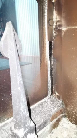

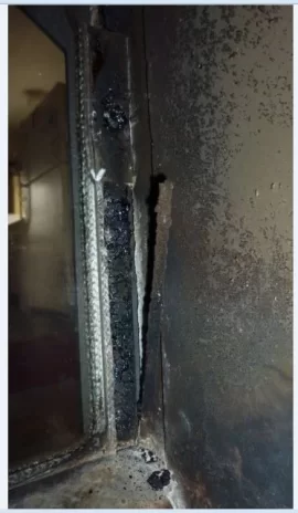

With mine, it finally got to the point where the stove top above the cat was going to 500 with the air cut all the way, so I pulled it and I'm running the Dutchwest
When conditions were right in the firebox, the air coming in that seam would ignite smoke in the box, and flame would shoot out 4-5" along the entire length of the seam. Before the leak got that bad I could run the stove a lot slower, with a cooler stove top. When the leak got worse, couldn't cut the air enough to get a low burn. I have the Dutchwest in now but I'm going to put suction on the flue exit somehow, maybe a vacuum cleaner, and check all the seams. I don't see any evidence of other seams leaking, as indicated by the thin white line where the creo is burned off the stone in the above pics of mine and Mryank9.Woody - why do you believe a leaky seam would cause the stove top temp above the cat to "go to 500 with the air cut all the way"?
Sounds like you know this but that's two panes of glass so it's not likely there would be any leakage around both of those gaskets. That will also keep the inside glass hotter, and it should be less prone to gunk up than most other cat stoves. I don't know how well your stacks are protected but mine are just top-covered and even though the Cherry and soft Maple I have is dried 2 yrs, if rain blows on the sides of the stacks, the softer woods will re-absorb a little moisture. They can even bubble out the ends a little bit on a new load.I did notice the inside glass gaskets seemed a little loose?
