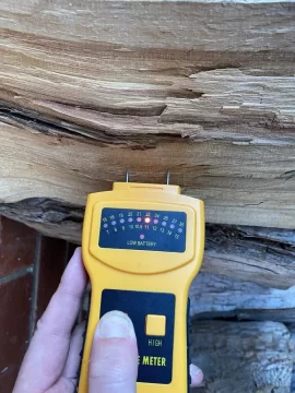

I promise, I won’t bother you anymore. It seems like you put a lot of research into your project. Can you tell us , based on what research, measurements , facts, assumptions etc you know that your wood is dry.
Dry means less than 20 percent on the fresh split, not to touch ,by the way.
ok.. .. please post the moisture content of the wood tested.. what is the MC of the pine VS the hardwoods your burning. What moisture meter are your using. How are you testing the wood.. please explain..If it is not clear already, the wood is dry. I don’t know how many times I need to say this.

Just before I post photos, do I need to prove anything else? Is it possible that people will claim I don’t own a stove or that my matches aren’t matches? Please let me know all the things I need to prove so that I can deal with them all in one go.
LOL, I watching this thread just for the fun.Your word is good enough for me, you have yet to say how you determined the wood was dry, give me a reasonable determination and I will believe you.
Please post the mc of the wood...If it is not clear already, the wood is dry. I don’t know how many times I need to say this.
Let me answer for the guy. "The wood is dry, I think I need to insulate the chimney, extend it, install block off plate and change my burning technique"Please post the mc of the wood...
Just a heads up ... Back on june 11th I suggested that you check the moisture of the wood your burning. Its 2 months later and you still haven't posted the moisture of the wood your using. Other members and I have asked you multiple times, your telling us the wood is dry with out actually checking it. As I posted back in June... Your making this as difficult as possible.. You couldn't be making this any harder than what your doing..Just before I post photos, do I need to prove anything else? Is it possible that people will claim I don’t own a stove or that my matches aren’t matches? Please let me know all the things I need to prove so that I can deal with them all in one go.
