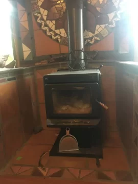

Below, my alcove. Tiles with air space behind. Been running safe for 20 years.

Is the air gap behind the tiled surfaces ventilated, that is open at least 1" at the bottom and top so that air can circulate freely behind it? What was used for the air gap spacers?

It’s vented through the back with aluminum pipe pieces for spacers.
it wouldn’t pass our local California codes ( neither would my house) but my stove has full sized bricks on the inside that keeps the sides from getting hot. I’ve done a few legal hearths. This isn’t one of them but i deem it safe.
I’m a builder and welder by trade. I have inteligente and good working sense.

Woodstock survival hybrid might work nicely in there
I would not put a stove in there that does not have full side and rear shielding like the Kent does. Call Woodstock and ask what they think.
If the enclosure studs are metal and there are no combustibles involved, then it would be safe. If framed with wood studs, then it is less so.

My Kent only has rear shielding.

I thought the Sherwood had a metal side cabinet with an air gap from the actual stove body, similar to the PE Super. If so, that acts as a side shield.

No that’s maybe the tile fire you’re thinking of? The Sherwood is single wall 3/16”. Top has interior baffle. I bricked the insides and bed which raised the box temps and lowered side temps and smoke output.
I have built shields for stoves and pipes. The most notable, in my sauna which has an old pot bellied that runs red hot. Simple stainless sheet metal reflectors with standoffs keeps the tile surround warm to the touch, not even hot.

Yes, must have been the Tile Fire. In that case, a stove like the PE Super or T5 or the Jotul F45 will be an improvement wrt reduced, side heat radiance. In cat stoves, the Regency 1500 and the BK Chinook and Ashford also have side cladding.
