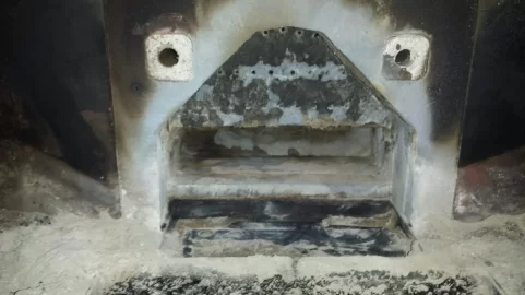

I'm interested in the Fire Dome cleaning/mainentance. I'm also not sure the differentiation of the shoe brick and Fire Dome. Is the shoe brick covering the fire dome so I can't see it? I've never had my bricks out and I've got a fire in there right now so I can't mess with it.

That photo in the other thread that you revived is the shoe brick. It, along with the other bricks in the firebox, can be removed to access the CP (combustion package) in the back of the stove. You cannot remove the CP from the front, as least not on my stove, but you can get a vacuum in there to clean out any buildup of ash. (Be careful, though, the CP is very fragile.)
Your backdrafting indicates poor draft, but a clogged AB wouldn't be a factor with bypass damper open. Sounds more like the weather and the wood, or your flue (is it clean and clear?). If the bypass is closed, though, trouble getting a good secondary could be due to ash buildup in the CP. That can cause backpuffing and smoke spillage, which can also result from shutting the air too far too soon.
I can almost always hear the whooshing sound when the AB is working well, but sometimes it is faint. If you don't hear it kicking in, walk outside and check your stack: you should see no smoke. You need a good coal bed, and burning smaller splits and branch wood can help with that when first trying to get coals. Yes, the wood must be very dry, and yes, the flue can get really hot while trying to get sufficient coals to engage the AB.
After two seasons, it is possible you have some ash buildup. If even with drier wood, colder weather and deeper coal bed you find you are not getting the AB to kick in, remove the shoe brick when the stove is totally cold and give the CP a cleaning.

AB looks ok. Yes, it's dirty and part is flaking off, but it's intact and should be ok. It was plugged with ash. I vacuumed it out. I'm thinking when I cleaned the stove pipe creosote may have gotten there then my fired turned it to ash. For 2-3 years of burning I'm not surprised it was plugged like that. I definitely should have read up and joined here sooner. I need to replace a fire brick, the shoe brick gasket, and the brick air gaskets. I think I will be fine until next fall though. I'm anxious to see how if performs now, but it's really not that cold right now. I'm going to get some more barrels to stage my wood in so that a week of snow and rain won't derail me too bad.

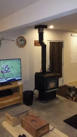

I hear the AB. It's not really what I was listening for, but now I know. I live in an extremely high windy area so the "woosh" that you guys described was going over my head. My "woosh" is kinda what I had pictured as my outside wind blowing and me hearing it in the stove pipe. I was thinking that the wind was blowing over my peak and kind of shooting down in to my chimney pipe last year so this year I added an extra foot to be further above my peak. I still hear the "woosh" but I know it's the AB. I will take pics and post my chimney pipe and set up to describe it better.
