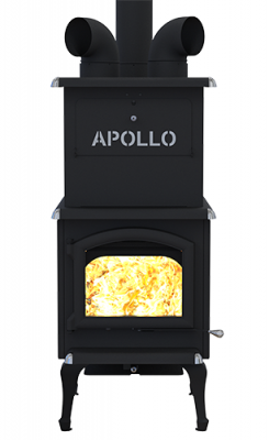

That’s a lot of sq ft for a wood stove installed in a basement. I think I would look into something like this or even a wood furnace.
