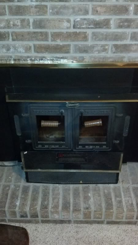

Wow, quick response. Thanks. I snapped a picture of my unit to get theball rolling.
Looking at that picture could the seal around the outside of the frame Need to be reworked to ulltimately seal it up?

Ok, the basics......just about every fireplace insert needs a full liner to operate well, however older units (such as this) may not have mentioned it in the owners manual because NFPA codes were different then!
You really can't do much of a seal on panels - although it's better than nothing, it's not the correct way to do things.
Start with this. The biggest reason for problems is that smoke comes out of the small hole on the top of the insert and then enters this big open chamber - vastly larger than the smoke pipe size! This has a lot of bad effects, including smell, poor draft, downdraft, condensation, etc.
Instead of writing a book here, met me make a minimum suggestion and also offer some reading material....
1. You should read about chimneys in our info sections - especially about smelly and reversing ones. You can dig through the articles or use the site search...
https://www.hearth.com/econtent/index.php/articles/chimneys_an_unexact_science/
2. You should, at minimum, do the old "to near the first flue time" installation. This means hooking a flex tube to the read of the insert ( depending on the outlet size you may need a boot) an making a good seal plate as shown in this and other similar articles:
https://www.hearth.com/econtent/index.php/articles/making_a_block_off_plate/
This type of installation may not meet the most modern codes (it depends on the size of your flue, etc.), but it is well above what the maker specified in their manual when the stove was built....and, more importantly, it may actually work!
Most folks just bite the bullet and line all the way to the top for peace of mind AND for better operation and less chance of creosote or smell.
