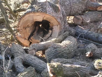

Haven't even got the stove set up yet, but we're busily collecting wood for a few years out. Husband cut a dead burr oak that died in the drought of 2011. He was sure it was dry. I was sure it wasn't. So he split a log for me and it measured 20%. From everything I've read on here that's practically impossible. The tree WAS hollow inside - been a den tree for years. Could that be a factor? Or is it more likely that my (er... cheap) moisture meter isn't quite up to snuff?

How deep did the pins go? Being hollow will help a little, especially if you have a lot of wind blowing through that "tunnel." Your M.M. reading could be corrected for species and give you a higher moisture reading. Just some random thoughts....

Okay, that was easy enough. Must have sweaty palms, though -- 34. But, of course, as oldspark said, the whole tree may be another story. The log I tested was about 9" in diameter before it was split. Still... it starts seasoning now fer sure.
I've found that limbwood can be ready surprisingly fast, but stumpwood can be surprising not ready for a lot longer. 9" isn't exactly small, but if it came from the top of the tree, that might be part of the explanation.
You'll probably be vindicated when you split the round from ground level. :cool:

Soundchasm is correct, the upper limbs could be dry as a bone in the desert while the trunk is as wet as a morning diaper. I dropped a long dead standing white oak last year and the upper limbs were burn ready but the trunk oozed moisture as the wedge went into the wood. It will be 3 years before I think about burning the oak.
