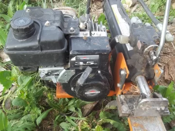

The Briggs and Stratton 3.5 HP motor on my little splitter has started smoking badly - and I guess I need to replace it. Here it is,
[Hearth.com] New Motor for little splitter [Hearth.com] New Motor for little splitter

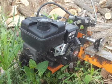

Can I replace this 3.5 HP with a Harbor Freight 6.5 HP motor? How do I do this? Just pull off the old motor and then figure out how to mount the new motor? For a small splitter this unit has been pretty tough.
Not sure what harbor freight is asking, but this might be a direct replacement, if the shaft matches http://www.amazon.com/93432-0192-Industrial-Muffler-Briggs-Stratton/dp/B0043SE07E/ref=sr_1_16?ie=UTF8&qid=1432855872&sr=8-16&keywords=3.5 hp horizontal shaft engine
same motor, different site with more info on it (broken link removed to http://www.smallenginewarehouse.com/93432-0192.html)
EDIT: here's another site that might be helpful in helping you match your engine to what might currently be available for a bolt up swap. (broken link removed to http://www.psep.biz/store/briggs_and_stratton_3_5hp_-_7_5hp_hor_.htm)
As Pen states - shaft size it the important part of this swap. If you don't get the same size of output shaft you will need a properly sized replacement for that half (motor half) of the lovejoy. Outside of that, this should be an easy fit and the HF Chondas have pretty good reviews.
I like the idea of replacing a 3.5 hp with a 6.5 hp. Do you think I will run into any problems due to the bigger engine (more power on the components)? The splitter is small but seems pretty stout. I think it would be fun to soup up the lil' Brave.
Shouldn't be a problem. All run around 3,400 rpm. I replaced the five horse Briggs on my splitter with the HF 6.5 and it has worked like a champ for years now. Shaft was longer so I just used longer bolts for a stand-off on the pump. Three buck fix.
Thanks for the info. I think I'll pull the little engine and inspect the shaft and compare it to the HF motor.
Why is it smoking? Might be much easier and less expensive to rebuild. Maybe not. Just saying.
I've run, on average, about 15 cords per year for 5 or 6 years through this little splitter. With 20 % of that being red elm. I noticed the smoking when a tough piece of wood was being cut. (It didn't smoke at all before this). When the splitting part had the most resistance it started smoking.
But as soon as it cleared this resistance it stopped smoking. It got worse to the point of smoking with no resistance so I shut it down. The smoking issue only lasted for about 20 minutes before shut down. I figured the rings were toast. It could probably be rebuilt. It was a good little motor - very dependable and predictable. Ironically, I had a new DHT 22 ton splitter in the wings. But I still used the small splitter until I had no choice.

The BS engine on my old Speeco splitter emitted enough fumes from burning oil that I replaced it with a Honda last fall. Shaft size is critical, but also important is the physical configuration of the new engine. In my case the Honda was a little wider than the old engine, and just barely cleared the wheel. Works, but another 1/4" would have been problematical.
