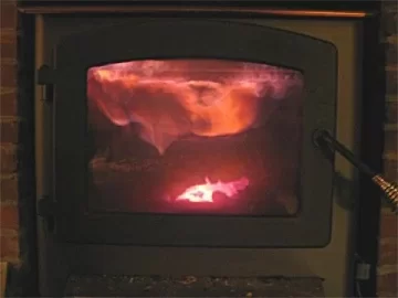

Burned the whole first season in my 30-NC with one year seasoned oak. Your only issue will be lack of consistency in the burn. Sometimes the sucker would take off like a rocket part way through the burn. Some to do with moisture but most to do with the lignin in the wood. Here is a 28 minute thermonuclear rocket blast with at a minimum 25 percent oak. Don't know what cedar is gonna do but that stuff can burn really hot. You have an interesting season ahead.
