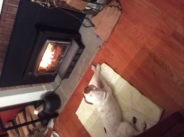

So far we have been using when it was chilly. For the last week, it's been pretty cool so running more. 1900 sq ft, 14' height from top of stove to exit from chimney. Insulated smooth walled liner. Exterior chimney. Good draft, never had a puff back at all so far. Did fully insulate the FP with roxul and durock. This seems like it makes a huge difference in how much heat is retained in stove. Good advice Hearth!
Here's the stats so far-
Several 8 hr and 10 hr re-lights with smaller fires. No big deal..
Temps last couple nights in the upper 20's and day times in the 40's. A mix of hardwood and Oak, some really dry, some so-so... Lit around 6:30 pm. House 67. 1 hr later main house 78 and bedrooms 72. 2 hrs main 83 and beds 73! This thing puts out HEAT
Got up this morning at 6am blower still running and top temp 178. Maybe 1/3 gallon worth of coals left at 11.5 hrs! Raked forward and opened air and door for 5 mins and the coals got cherry red. Added full load and it re-lit in about 6-7 mins. 10 mins cut air by 1/3 450 temp. 10 more mins 2/3 and 550. 5 mins more 600 and shut down. Came home at 5:30PM blower still running and house at 77. Raked coals forward and left until 8 since house very warm... Added load and away we went. Almost 14 hrs on relight. This is the 2nd time at 14 hrs!
So strategic fan placement and I am heating whole house. Impressed with this stove!
Do need to pay attention to cuts and splits. I still have a lot of "I don't care" fireplace lengths and it is tricky to get a full, tight box. Most is split on the small side as well. With 16-17" and 'square' it's easier to get a full box. Loads N-S easier, and with 14 hr reloads, I'm good.
Dog 2 LOVES it! Wife starting to love it. She's even done a couple cold starts now. Doesn't stare at it for an hour after relight like the dog and I, and could give a s*** about secondaries, but more than I ever expected.... Have ordered her some super cedars based on Begreen's rec. She will be all gity when she can abandon the paper..
Thanks all for your help getting here. Haven't burned a drop of oil yet. Waiting for some real cold to test

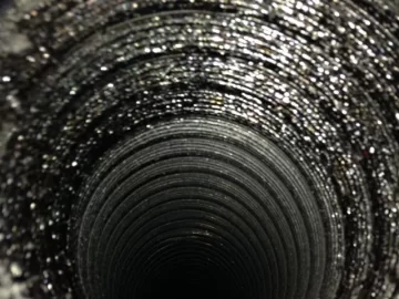

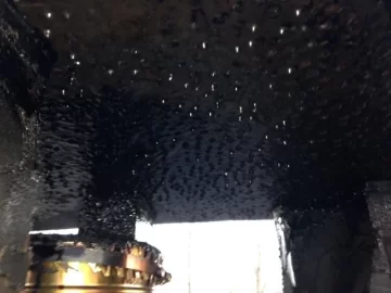

OK, So I tried to start it up tonight when I got home and it seems to be worse then before. Had a hard time getting the fire started, and after 30 minutes or so, it went out. No vents / exhaust fans running in the house. I even opened up the sliding doors in the stove room and several windows and waited 30 minutes. Had huge amounts of back draft / smoke pouring into the room whenever I opened the door. What's odd is that this has only occurred in the past 2 days. I installed this a month ago and have not had issues before.
Some additional info on the home layout. The stove is on a first floor extension of a 2 story colonial, the chimney is only 1 story, but is about 15 feet from the rest of the house (2nd floor outside wall). The liner extends about 5 inches above the clay tile, and the entire chimney is capped with a 2 x 3' piece of slate perhaps 8 inches above the top of the liner. The liner has a peice of expanded steel covering the opening. Is it possible that the grating got that clogged in only a month of burning, maybe 20 fires? I checked tonight, and smoke was coming out of the chimney from my failed fire attempt.
To me it sounds like some blockage. If it was working fine, than some blockage sounds logical. You should check!
Reactions: Swedishchef
Agreed. If this is a situation that occurred within 2 days, something is blocking somewhere. Birds in the chimney/liner? Blocked cap?
Let us know..
Andrew

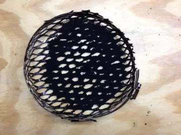

Absolutely! If you were not burning hot, if pieces of paper or ash, etc got into it. I have seen pictures from forum members which easily show that their spark screen is clogged tight.
Keep us updated!
Andrew
So the answer is, yes, it can become clogged in a month. Went up there this morning and took the cap off. The slate covering the chimney is covered, and was almost driping. You can see in that shot of my liner where it enters the chimney vs exposed to the air.
[Hearth.com] New Osburn 2000 insert burn times [Hearth.com] New Osburn 2000 insert burn times [Hearth.com] New Osburn 2000 insert burn times
That almost looks like tar. Are you sure your wood is seasoned? When you say it's 23%, is that after you split it. Or from the outside? There's a big difference! You need to split it and then measure the moisture. If it's good, then perhaps your burning at too low a temperature( although you stated you burn in the 500's. But I would guess it's the wood!
That may be the reason you say you can only get the stove to around 450! Please check the wood!
checked on a freshly split face. The deposits on the slate were pretty tar like. I'm going to try loading a bit less wood with more spaces. I was only getting to 500 occassionally. For the first few weeks, I was only hitting 400-450.
Next question, what's the best way to clean that stuff up?
