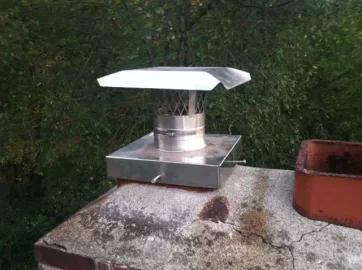

Raising the slate would be a pain for sure! It looks like you do have some room to increase the height of the screen though? On a 6" diameter liner, you have a flat surface area of about 28 sq in. If, instead of flat across the top you can have a raised mesh area (say 5"H) x the 18.84" length (circumference of a 6" diameter) you would increase your vent area to approx 94 sq", or 3+ times the area! If you made it conical (larger at the top) it would increase more.
Cut a piece of coarse expanded metal from Homedepot, Lowes, etc (yours looks fairly fine?) so you have a cylinder that fits around the 6" liner and overlaps itself 2" or so (maybe 21-22"?). For the height, measure from the top of the liner to the bottom of the slate and add maybe 2" so it can be slipped over the liner and a hose clamp to hold in place. If it meets the slate uniformly, I wouldn't do anything else. If not, leave the height about 4" longer and cut into "peels" at the point where it meets the slate and fold over inward to close the top.
Kinda like this pic (imagine the top cap is your slate)

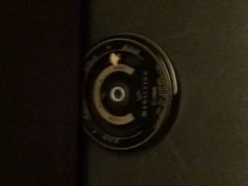

My stove loves to run in 600-700 range, I measure with a condor medallion stove top therm on the center of the stove top as it states to do in the manual. If your burning in the 300-500 range I would think that's too low to get the clean burn. It's nice to have other 2000 users in here !

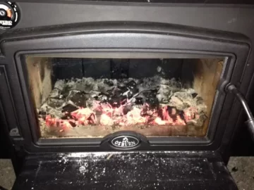

Would you guys mind posting a pic of what your initial load from a cold start looks like? Removing the clogged grate fixed my draft problem. Just loaded up and it only got to 475 before starting to drop. Checked each piece of wood; ranged from 19-21%. I have a feeling I may not be loading enough wood to get to the high temp on a cold start. Usually 3 4-5 inch splits on the bottom with two more layers of progressively smaller splits / kindling on top. What temps do you start to turn down the draft?
Unfortunately for me, I needed the heat shield for my install, so I can't read the thermometer if it's on the top, I have to use the front face.

You need more. I load 5-7 medium splits from a cold start. It lasts me 5-7 hours.
Your burning methods kinda need to be tweaked, there is some glaze creosote there and it seems early for it to start accumulating. The quicker the Fire gets to a hot temperature and secondaries going, less junk in the chimney. My secondaries, from a cold start, normally ignite between 15- 20 mins.
I had to install the shield as well. Design limits any use of stove top including thermometer use... A slightly steeper angle would be better.

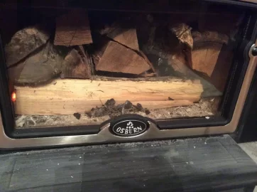

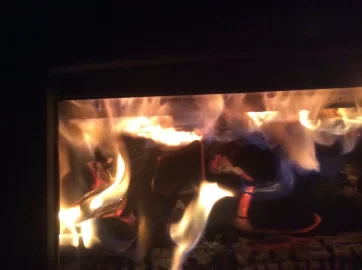

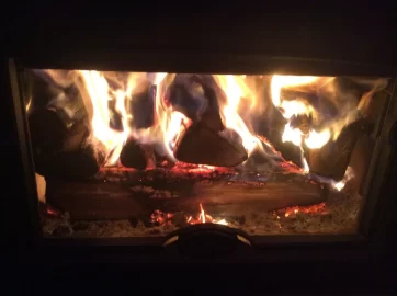

Tonight I am trying the first course laid EW and 2 courses NS on top to see if I can get longer burn. Total splits about 10 and mix of dry and ok wood (pic 1). Stove was 236 when starting. It took considerably longer to get things moving this time. I expected some delay, but was almost 20 mins before I got good flame and another 5 min to get 450. Started to cut back at 450-500. Again at 500-550 and turned fan on low here (pic 2). Waited another 10 mins before cutting back all the way. Stove was at 600-650 with full char and a fair amount of secondaries cooking. Last check, stove had settled some to 500-550 and cruising along (pic 3). Hope this helps. It's getting hot typing next to this thing!

Filled it up with my first N/S fire after the cold start was down to coals around 8:30. Put 1 peice E/W in the back to level off the bottom, then filled it up to the tubes. After about 20 minutes, the stove was around 575, then settled in at 500. At one point, it dipped back down to almost 400, but 10 minutes later, kicked back up to 500-525, where it stayed for as long as I was up. Checked it this mornign at 7:00 and the stove was at 150, with a few large chunks of coals in the back.

I think I have been turning it down way to early, and not loading enough initially. The N/S worked much better; the only issue I have is that most of my delivered wood is not stove length, and I'd have trouble getting them to fit this way.

I find NS loading much easier and I dont have to worry about the front log rolling against the glass after the pile settles. That said, much of mine is cut to 16-17" with the longer pieces saved for the same rear EW piece. I did cut about 2 cord at 20" when I read it will fit in this stove. However, it would be a major effort to fill it EW due to the considerably smaller door opening... Got another year before I have to deal with that pile though!
I think your right about turning down too early, although I have started to cut back sooner since the stoves continues to run up due to the improved cold weather draft I presume? As far as not enough, you should still be able to get a hot, small fire just wont last as long. My early burns during the warmer days were 4-5 of my small splits and I could get up to 600 easy. Look for smoke from sack at 20 min intervals. I do this from time to time to see the correlation of temps to actual smoke output.
My experiment last night seems to have yielded marginal, but positive results. When I got up at 6AM, there were more significant coals left then previous, and relight was very fast. Blower still on and the laser said 220. House main was 74 and back bed 64. It was 19 out and windy so could see the difference in the house temp this AM for sure (not that 74 is cold!). Will be cold again today/tonight. 1x is not much of a sample size, but will do this again for more validation. With continued buy-in from the wife, I think this will easily be a 24/7 primary heater for me.

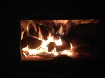

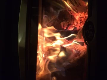

I just threw in six splits in n/s fashion. Blower on medium all at 6pm. Pic is wood 45 minutes later , getting hot in the stove room, go to utube and type in Osburn insert secondaries and look for it being posted by etiger2007, also a pic of my heat shield I put it on the wood itself. I also load my stove with kindling from a cold start with a small split or two on top because I want to get things hot fast, I'll post a pic tomorrow when I do it, looks like I'm setting a log cabin on fire !

Cold start still only got up to about 475 last night. I can't seem to get the bottom splits in the rear to burn initially if I load them E/W. If I do 3 on the bottom, the first gets going nicely, most of the 2nd, but the 3rd just chars over. I know this is what you're looking for for longer burns if you pack it tight, but I'm trying to get it hot first. I feel like the 2nd and 3rd layers of wood burn down to coals before the stove can really take off, and only 1/2 splits on bottom that are actively burning aren't enough to get the temps up. This time, I even tried putting two 1" splits N/S on the bottom to let air in.
Reloaded n/s again at 9:00; stove went to almost 600 and then settled in around 500. This morning at 7:30, plenty of coals for a relight, blower still on and stove at 200.

I have to believe that your stove top is getting hotter than the left corner of your insert. Is it heating your house ? I will shoot my left corner with the digital therm and see how much difference there is.
Thanks for checking. Yes, it's heating things fine. Gets the first floor to 72-74; but I have a very compartmentalized floor plan. My concerns are more with the speed that the grating at top of the liner clogged up, and the tar on the slate cap. Obviously not burning hot enough. Renjilj seems to be getting readings of 600+ on the same location as I am.

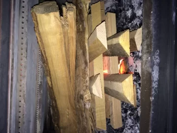

Here's a pic of my cold start, I also compared my stove top to the left corner and there's about a 100 degrees difference between the two with my set up, tar and clogging has to be because your burning green wood !
Back to the cold start load, I burn this load wide open with the air control to get the unit and the chimney liner warmed up good.

I have no issues getting the stove or house hot. I know Ed gets his hot as well. What if you take the screen off the top of the liner for a few fires? Unlikely to get critters this time of year especially if burning continuous. It will remove that variable anyway..

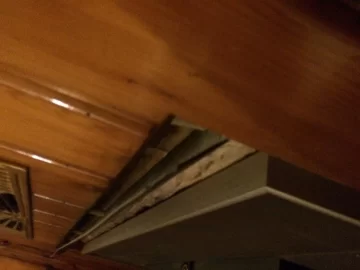

I like that heat shield location better than the Osburn which is right above the stove at the bottom of the surround. It blocks the top of stove from anything useful (therm, pot, etc) and, although I have gotten used to it now, it's an ugly duckbill looking thing. How did you speck that out?

i just went with the manufacturer specs from the home saver heat shield , no real scientific method. It comes packaged much larger you just cut to size , I wish I would have made it alittle bigger and for roughly $70 I can order a new one and do it again. I did do the air all the way closed and had a better coal bed to start with in the am but useful heat was gone in the eight hours it was running because the furnace was on, it was in the single digits at this time .
