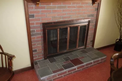

Just bought the house last December. Built 1969. The fireplace had its very first fire ever after we moved in.
![[Hearth.com] New Oslo fireplace install. Updated 9/14. [Hearth.com] New Oslo fireplace install. Updated 9/14.](https://www.hearth.com/talk/data/attachments/138/138212-b82c5f2cdb3c11aec2c748a61b24e05b.jpg?hash=ZaPlONWg0L)

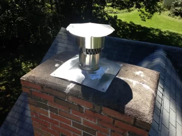

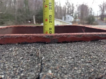

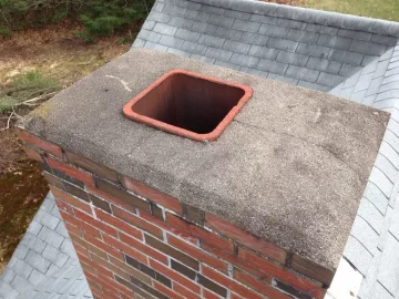

Got up on the roof and checked out chimney. About 17ft top to firebox floor. Perfect.
![[Hearth.com] New Oslo fireplace install. Updated 9/14. [Hearth.com] New Oslo fireplace install. Updated 9/14.](https://www.hearth.com/talk/data/attachments/138/138214-0582c38d4625724977df6f584ea50813.jpg?hash=ac9gXuLtfc)

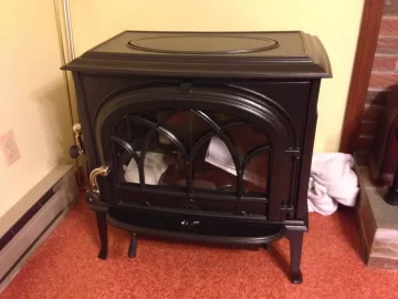

Brand new Oslo blue/black brought home in March. I was going back and forth with the Oslo and F55, but the F55 rear vent was all of 3/4" too high for the fireplace and I didn't want to go through the trouble of destroying the hearth. Oslo it is.
![[Hearth.com] New Oslo fireplace install. Updated 9/14. [Hearth.com] New Oslo fireplace install. Updated 9/14.](https://www.hearth.com/talk/data/attachments/138/138215-9bc1f77a0c532478b9c6480e6f478164.jpg?hash=grMaiBAQjM)

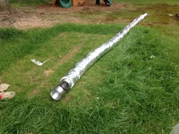

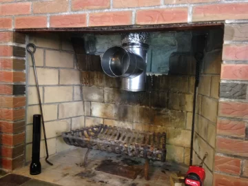

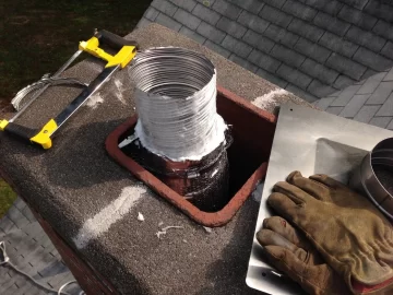

Purchased liner from Rockford. Had to cut out a bit of damper frame and knock out a few firebrick. Now it's pretty much a straight drop. The damper itself is a nice piece of cast iron with the company name cast in to it so I'm going to clean it up, paint it, and use it as a mantle heat shield.

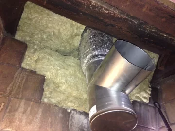

![[Hearth.com] New Oslo fireplace install. Updated 9/14. [Hearth.com] New Oslo fireplace install. Updated 9/14.](https://www.hearth.com/talk/data/attachments/138/138217-d84485bbfd14f7d33984ddb7dde5d646.jpg?hash=4hSiSFRaUU)

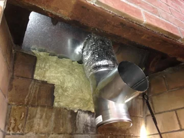

![[Hearth.com] New Oslo fireplace install. Updated 9/14. [Hearth.com] New Oslo fireplace install. Updated 9/14.](https://www.hearth.com/talk/data/attachments/138/138219-85828074e8a64d4e582c9f40d9ae9c04.jpg?hash=xzEdDh0iWy)
Still have to stuff some Roxul in there and make a block off plate before sliding Oslo in to place. More to come...

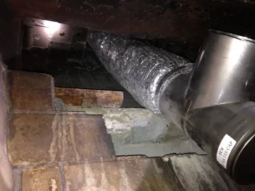

![[Hearth.com] New Oslo fireplace install. Updated 9/14. [Hearth.com] New Oslo fireplace install. Updated 9/14.](https://www.hearth.com/talk/data/attachments/138/138389-1ba965d42ead089d8009cf6c70fb376a.jpg?hash=LsnOndL6sM)
![[Hearth.com] New Oslo fireplace install. Updated 9/14. [Hearth.com] New Oslo fireplace install. Updated 9/14.](https://www.hearth.com/talk/data/attachments/138/138390-7c5a8486ab98352f7b7e03e533f31ab6.jpg?hash=hwWmmgK727)
![[Hearth.com] New Oslo fireplace install. Updated 9/14. [Hearth.com] New Oslo fireplace install. Updated 9/14.](https://www.hearth.com/talk/data/attachments/138/138391-fde3ce9ec8018d60a99b627c2e6e7590.jpg?hash=8YSfQZ8Pgb)
