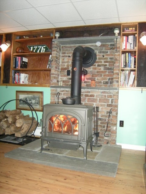

My setup (photo below) is running 6" double-wall, ...to an 8" (stainless) instulated, ...from rec-room (raised ranch) to about 4' above roofline.
Once I get a good draft going (a couple sheets of newspaper will do it), ...the stove starts right up and the front lever seems quite responsive.............................. with the right wood.
Bottom line, ...with typical seasoned wood (Oak, Maple, Cherry, Locus) it burns fine, and the burn can be controlled with the front lever. I have had times when I've filled it with some really dry stuff, ...and it's tough to slow down. On the other hand, ...I've had some damp wood, ...where full open, ...it burned slow.
My only point here is that I'm VERY pleased with my Oslo, ...yet the wood seems to be a big factor on how much you can control the burn.

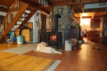

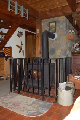

My battery is charged so here are a couple of more photos.
The house is not exactly clean but I think you get the idea.
I designed and installed the wrought iron shortly after my first daughter was born (4/21/90).
We were afraid of her getting burned. 20+ years later and 2 more daughters without a burn. Except me of course.
We have gotten used to the extra area to dry wet mittens, hats and towels. so we kept it.
