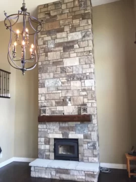

Stone is all done. All that remains is to mount TV bracket in a couple of days once the mortar has fully dried.
I gotta say the stone looks way better than I thought. The stones' colours pop a lot more when vertical than when they're sitting on the floor.
Here are the pics... (I'll post up a final one once the TV is mounted) .

Sweet, that is an impressive sight. Nicely done. Have you worked with stone before?
No I have never worked with stone before and I still haven't [emoji16] . I payed someone to do it. It would have taken me far too long to do it myself and probably way more waste then the stone guy. I just helped wherever I could. I was his apprentice. [emoji4]
Good experience. It's nice that he let you work with him.
Very nice. Your stone mason does fine work.
Thanks
Ya he's really good. He does most of he fireplace finish work for the company I bought my FP30 from.
He's actually a carpenter that does great stone work.

Really came out nice. Thanks for all the pictures and info along the way. Very nice job, should give you years and years of enjoyment and heat.
One question, where's the heat?! We like to see fire!
Reactions: huauqui
LOL. I know what you're saying. I can't fire it up till this weekend as per my stone guy. He said if the mortar dries too fast we may get gaps between the stone and mortar.
The TV is going up tonight so I'll take some more pics and post them tonight. I'll take some close ups as well.
Thanks. Yes we're looking forward to many years of wood heat with it.
Fantastic installation. That will provide a lot of pleasure for decades to come. With that beautiful stonework, the only thing out of place is the TV. It's kind of jarring next to all that fine workmanship and the nice mantel. But, sign of the times I guess. Nevertheless, well done and enjoy!

Hi saydinli, The install looks great! There is a wealth of info on this site! How wide is your hearth? I will be installing the FP30 next year and was wondering if this unit would look too small with a large hearth approx. 8ft wide by 15ft tall? What are people's thoughts?
This may sound funny considering the hearth was done this year, but "I think " it is 6ft wide. The reason I say "I think" is because we went back and forth between 5.5 ft and 6ft and I think we settled on the 6ft. But I will confirm for sure tonight with a tape measure .
schat.. my hearth is 7' wide with stone 14' up to a vauled ceiling. I think it looks great. It's not huge but doesn't look small either. I think you will be very happy!! To report back on my vibration issue. I installed a new fan and wedged some fire place gasket under the other fan and that seem to have salved the issue. Will wait and see if it comes back. Time will tell.
