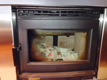

This is my first post on the forum. I have been reading the forum for a while. I was shopping for a wood stove insert. End up getting a Pacific Energy Neo 2.5 with a rigid liner from the stove to the top. The chimney is on the exterior wall but inside the house. The insert was installed yesterday and it is great so far except the fire seems to be more active on the right side then it is on the left side of the stove for some reason. The glass is dirty on the left side about 25% of the total glass. But the rest of the glass is still super clean.
My wood is mainly season ash and some maple. The stove pumps lots of heat and I get nice blueish secondary flame for quite a while.

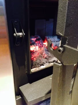

If the latch needs adjustment after the dollar test, how do you adjust it? There does not seems to have anything to adjust. Do I pry the latch out?

The doors don't come adjusted from the factory, so you will need to check the adjustment with "the dollar bill test".

I did the dollar bill test and it is super tight all around except near the latch. It is not super loose but not hard to pull out. The impression on the door gasket is deep all around the door but barely visible near the latch. So the latch probably needs adjustment.

Here is a picture of the latch. There does not seems to be anything to adjust.

And here is a better picture of the insert with the dirty glass on the left side. As requested by Jeff_T.

No, don't tighten it any more. As long as there is some resistance, you're good. Too many make the mistake of wanting the thing too tight, and that prematurely wears the gasket down, and puts unneeded strain on the latch, which wears the cast door prematurely, where the latch pivots against. I know this from my own experience. Don't make that mistake, I already made it for you LOL
Make sure as pointed out, that the knock out was removed. One side black could also be simply the wood was closer to the glass, or the wood on one side was not as dry as the other. Unless this becomes a common issue, then there will be something else to address.
Edit: You latch is different than the rest of the PE lineup, so maybe it does need a little more adjustment. If they are using the high density gasket on that model, you don't need to go real tight.
We need a picture of the whole install. Just to look at. I like the stainless surround.
Are there washers under the latch to take out?
No, there are no washer to take out. But thanks for pointing it out. Did not thought about that.

My glass also seems to become cleaner. At lease 50% of the black is gone and the rest is slowly fading away. I use to have at least 4 inches of black on the left side, but now I have 1 1/2 inch maybe. Maybe there is a break in period. Been using mine for only 2 days
How is your burn time? Last night, I put one 8'' split in the back and one 6'' in the front. I rake all the coal in front before adding the split. Once the the fire was establish, I set the air setting to fully closed. This was at 11pm. This morning at 6h30am, the log in the back was still in one piece glowing red. The fan was still on blowing hot air. I am very please with this result. The insert was far from being packed last night.
Load that thing north to south, and keep the ends of the splits a few inches away from the glass.
