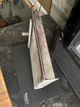

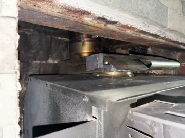

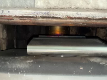

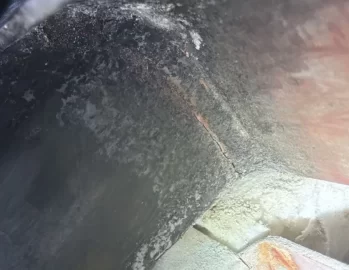

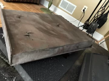

Video and pictures of the baffle and two shots of the connection.

I'm not a PE expert, but seems the soot issue is a weird one. I have to believe its related to how the offset is installed. The problem is the warm air is pulled through the interior shell of the stove body through the blowers, how is soot getting in there? I hope this will get resolved for you, PE is a top notch insert, the baffle looks ok, no sign of stress for it. Hoping for you your local PE rep can get you some help.

I don't see signs of overfiring here. It is worth pursuing this issue with the factory rep.

That stove showed signs of overfiring. This one does not.

I emailed PE, and I told them that I’m not interested in doing a draft test… all I want is to fix my stove. They came back and said any competent local welder can do it using soft metal procedures.

Being the stove is an easy breather, draft should be around 0.05-0.10" WC I'd think? If it is overdrafting with that off set box, I wouldn't think it'll be easy to get to. I've never tested an insert, but free standing stoves we would go about a foot off the stove top, drill a hole for the probe, then seal it after with a screw, touch up with black paint and of course, put the screw hole in back of pipe. And yes, you try to find the problem as well as work the solution if you're coming from PE's point of view. Best for all concerned, MFR and customer.

Your stove was clearly overfired badly. This one shows no signs of it at all

Again I see no evidence of over firing in this stove. Its a crappy install for sure. But not over fired from what I see

As noted earlier, I don't see signs of overfiring either. This looks like a bad weld job. The offset box reduces draft. It's possible that the draft is within spec. I'd get an inexpensive Dwyers and drill the test hole in the appliance adapter to test draft. If it is within spec, say .04-.08", then I would ask for a replacement stove. The reason being, one doesn't know what other welds are suspect.
If you want to add a flue probe, the test hole can be at the front of the pipe. If not, drill at the back and close it off later with an appropriately sized bolt.

All the welds look like that, even on my new stove stove
