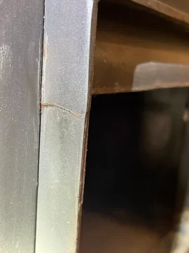

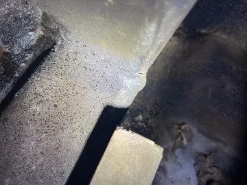

I have pacific energy spectrum and found cracks in the upper inside front corner welds. I was wondering how many people have dealt with this and what was the outcome dealing with pacific energy. Any information would be appreciated. Thanks
The first step is with the dealer. They should come out and document the issue and escalate it to PE if it is found to be a warranty defect.
Would it be possible to post some pictures of the firebox and of the cracks?

I sent pictures to dealer as requested. They got back to me and said they would need to do a draft test on my woodstove, charge me $250.00 and drill a hole in my double wall pipe to do it. I refused. He then told me that PE was not going to warranty my stove.
The good news is that both cracks don't appear to be too serious. If they get attention soon they can be rewelded. The first one looks like a weld failure. Where is the second one, the air wash diverter??

The first batch of pictures was the left side. The first picture in this batch is the upper right side. The second picture is the door flange where the crack from the weld ran down to from the upper right side (first batch of pictures) I purchased the stove, all piping and had them do the install. I did all this to protect my invest when I purchased it. I have approximately 15 feet off piping straight up in a 1300 sq foot house. To say I’m disappointed with the response from PE energy is an understatement. I own two pacific energy wood stoves and have supported them and recommended them for years and years.

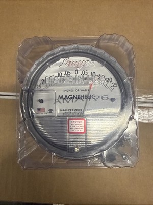

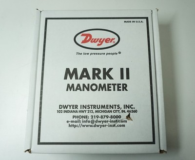

Wow that’s pretty cheap, thank you. when I asked him why the price for the draft test was so high he told me the tester he had to order was $1500.
That is one deluxe manometer. Most use a standard HVAC manometer or magnehelic. They come in various reading ranges. You will be looking for a reading somewhere around .05" ideally. A range of .00 to .2 would be ideal but may be harder to find. The one I showed will cover the low end well enough. If the draft is > .1 it's too strong for some stoves. Here is a magnehelic that would do the same thing.
New - Used - https://www.ebay.com/itm/167941956323
The test is done with the stove running. It needs a section of copper tube at the end in order to stand up to the heat of the flue.
