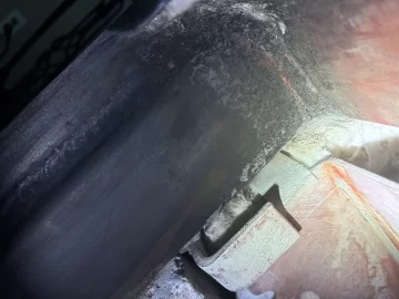

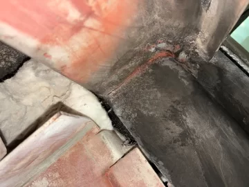

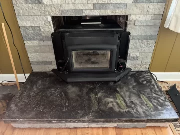

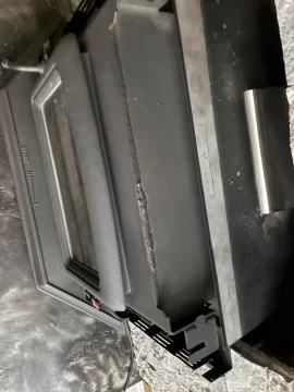

I have a pacific energy super insert LE and three welds are cracked. How would I get it fixed without the distributor and manufacturer? My thoughts are that the stove is compromised and needs to be replaced PE wants to do a draft test during cold weather. The distributor has been a nightmare since they swiped my credit card. They are in Southington CT and their name starts with a S. Run don’t walk to get away from that outfit. I didn’t get on here to slam them but whenever anyone talks wood, stoves… I make my feelings known!!! I’m where I’m at with this and trying to move forward. Any advice would be appreciated.

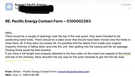

Sorry to hear you have had so many issues. This definitely looks like some installation errors occured. The indoor air intake should be open unless the insert is setup to draw outside air. I haven't seen the back vent covers before, but I strongly suspect they should not be open for normal operation.

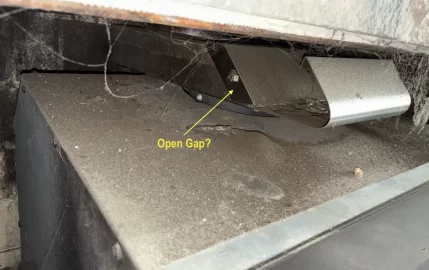

It looks like an offset box is on the flue outlet. Is it not tightly closed? It's hard to tell from the picture, but it looks partly open on the side. If so, that explains the tempermental draft and soot issues.

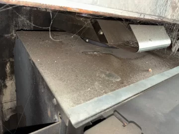

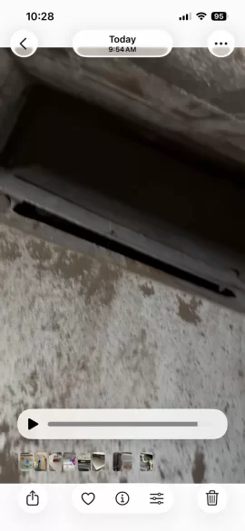

That stainless steel, see the bolt head ? Where the bent metal meets the angle is a gap. It looks like some sealant is blobbed up on the bent piece. Previously when the liner was cleaned they went through the firebox and up. This time he removed the surround and unbolted that piece giving much better access. Inside the firebox on the back wall is a rectangular tube which brings air to the baffle. I think the soot filled that tube (air wash) when they went through the offset box, then when the fans come on, presto magico soot flies.
If they pulled the baffle and didn't put a rag in the feed tube, that's not good. That's not the airwash, it's the secondary air feed. Clogging that up will definitely impede performance by filling up the EBT-2 box. If that's what happened, it needs to be cleaned out.
That said, it should not be how soot got into the convection jacket, which should be completely isolated from the firebox. The soot issue is a different kind of careless. Maybe they spilled a lot on the ashlip and underneath it? If the blowers sucked in the soot from the hearth, that would make sense.

That first picture on the first post is pretty disappointing. That weld looks pretty rough where that crack occured. It looks like there was a defect in the weld and the welder ran another pass over it, and not a good one at that.
The rest look like solid welds, the cracks are at the toe of the weld, the weld didn't fail, the parent material did in the HAZ. It sure looks like the stove was overheated.

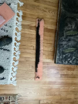

How does the baffle look in the stove?

The baffle looks fine (to me anyway), it’s got minor warping on the topside piece but the bottom perforated piece looks good.

Take a picture of the baffle, so we can see it.
