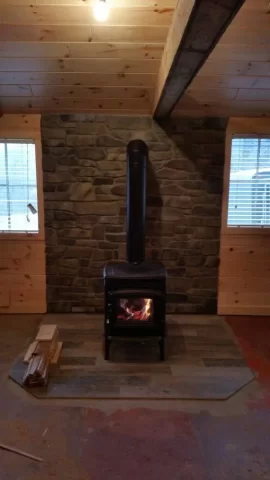

Here’s an update and thanks for all the valuable input. Very helpful in this decision. I decided on the F45 Greenville and very happy I did. After I did the temper burns I spent the night and enjoyed a nice warm night. A much more even heat and a LOT less wood than my old stove from the 20’s. The concrete floor is being covered this week so hoping that will help because as of now it takes a day or so to get it up to room temp. Last few nights were in the teens and it perform great. The foam insulation is awesome in keeping the cabin warmer longer. What a difference from where I was a year ago. Safer and warmer! It definitely likes dry wood which is all I have. If I fill the firebox in the evenings I have a very warm stove even with the damper all the way down so still working on getting used to it. During the day I only feed one piece at a time. Other than that very easy to control and feed. Cannot say enough good things so far. Picture attached of installed stove with double wall pipe. Thanks again for the feedback.

Nice looking installation and stove. It's great to hear that the F45 is working out well for you.
