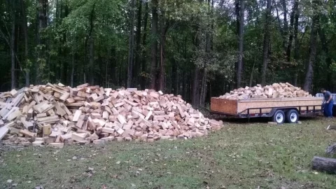

Didnt take long and the pile kept growing....

What is the source of the blocked wood? If not already dry, be careful when stacking that stuff. Need to let air get to it.
Reactions: STIHLY DAN
Its pallet runner cuts. Its been in a pile in the open for several months at this point. The fresh pile I have now will get weathered for a few weeks minimum. How long should it stay in the pile out in the open? If some of it isnt dry, will it rot out or..?
Will the open sides be insufficient for drying?
Keep in mind... very new to long term wood storage.
Thanks for the input.
Congrats on your excellent setup, that appears to be a lot of firewood. I am wondering how all flat surface will do in the firebox. Have you any experience in using such firewood?
Open side sheds are better than closed for the purpose of seasoning. If the wood is already below 20% moisture it is pretty much a tossup how you want to go. If your square firewood is not seasoned or kiln dried, you would want air circulation to the edges of the pieces. I have only used split hardwood and do not cover at all, it seasons very well in the open over 2-3 years.

Looking good, you will be warm this winter for sure.
Those cut off are awesome, do you pay for them or are they given away
That's a great source of wood, I am very jealous. But the issues that others have pointed out is that the wood stacks so tight, there is no way its going to dry. So unless its already dry, ~20% moisture content, then you are going to have troubles keeping a fire going, and creosote build up will be a problem.
Hmm... how long should they stay out in the open or what is a good way to tell moisture content without a meter?
As far as cost... I wish it was free... it used to be. The trailer shown in the pictures above is a modified 18' car hauler with 2' sidewalls. I'd venture to say close to 10k# on the trailer... $120 per load and they load it.
That's very cheap. 5 tons is about 3-5 cords of firewood, if it is dry and depending on species. $120 is a bargain for that.
Even if it is green wood, it's still a bargain.
Based on some rough math... the trailer is heaped at close to 6'.. I cut that back to 4' on paper as its heaped, not stacked.. but yeah.. 3.5 cord.
Ive hauled 5 loads that size... my wood shed will hold 8-8.5 cord tightly stacked. The 8x8 shed stacked should be around 3.5 cord. Looks like my pile is bigger then my storage space... lol.

Do you know if the wood has been kiln dried? If so you might be OK stacking like you are. Probably worth getting a moisture meter and splitting a few to see how dry it is.
Reactions: Mr4btTahoe
They must be making some damn big pallets. I would think the wood would be dried for that pallet making.
Someone else posted on these forums with the same type of lumber cut offs, was it you? It's going to suck trying to season oak like that, or any hardwood for that matter. Looks like you've got an older, pre - EPA stove though?
