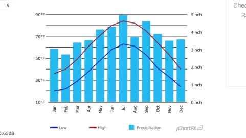

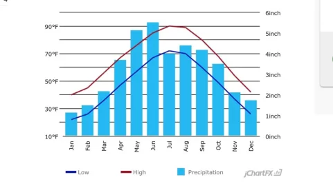

I assume you must be kidding, as it’s colder where I live, than any city I’ve checked in Missouri.
Mine:
[Hearth.com] New shop new stove
Kansas City:
At most, you could say the OPs climate is fairly similar but warmer than me, it’s not like he is in Alaska. And I’m not in Philly proper, it pays to keep the riff raff unaware of ones exact location.
