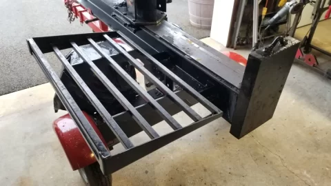

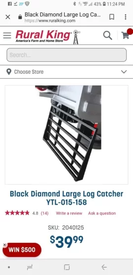

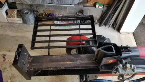

I can't recommend the large cradle enough sold at Rural King under the name Black Diamond. I weld as a hobby and had been using one I made. Decided I wanted something larger and found this one. I could not buy the steel for the price this is sold. Total shipped to my door was $54.

I'd also look at changing to ATF fluid at your hydro oil change interval. I usually save my splitting for the winter and it makes a difference in the warmup of the fluid using ATF compared to hydro fluid.

So I really want one of those log tables and both tractor supply & rural king both are out of stock and not available for backorder. I’d really like the bigger sized one if anyone knows where to get one?

I found 4 stores....all out of stock. It is worth the wait though if it's even still being made.

Is this the one?
(broken link removed)
It's in stock at Tractor Supply in many western PA/eastern OH stores. It doesn't seem that they're shipping this item directly to customers or via ship-to-store.

That is the little one. Still very well made, but once you use a large one, it is a night and day difference.
