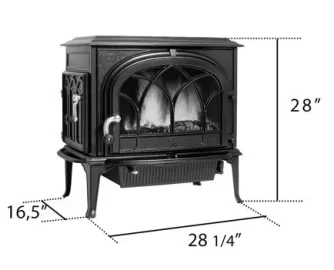

I have to say as someone with a Oslo in the basement of a 1000 sq. ft. home, much advice was given to get a smaller stove. Something else might have worked, but I've seen no down side to "too big".
Beautiful stove! The Oslo is rated to heat 2000 sq ft. if you have it in the basement is your main floor 1000 sq ft.? The basement must be 1000 sq ft right? Are you heating a total of 2000 sq ft?
Jøtul F 500 Oslo
•Maximum heat output: 70,000 BTU/hr
•Heating capacity: Up to 2,000 sq.ft
•Over 75% efficient
•Log length: 22"
•Burn time: Up to 9 hours
