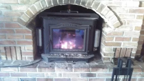

I am looking for a new stove. I currently have an harman 300i insert it's nice but to expensive to maintain to picket with wood. I'm look for a nice freestanding stove that's very durable efficient easy to maintain and I would like to cook on it. Our power goes out a lot so that's why free standing would be better for heat with no power. Thanks I appreciate it.

Do you want a rear-vent stove that connects to a liner in the chimney? How does the area in front of the fireplace look like? The hearth I can see there does not look deep enough to accommodate a stove.

1600 square feet have to build a bigger hearth. I'm in sunbury pa. I'm in the process of insulating my whole house little by little. Budget none. I always heat with wood it's everywhere here. I use 5 to 9 cords. I will post pictures when I get home of the whole section. I have brick on the floor in front of fire place for 27in out

Given how high up the fireplace is, you could maybe put a top-vented stove in front of it. That would greatly expand your selection and be easier on your budget. How tall is the chimney? Does it have already a liner? Are there any concerns about clearances? And what is the r-value of the brick hearth that you laid out in front of the stove? Just one course of bricks or is there any other insulation underneath?

We need to know whether you need a rear exit stove or if the hearth will be modified enough to give height for a top exit stove. If the hearth is lowered for a top exit stove, then the Englander 30NC or the Drolet HT2000 both provide good value.

I think someone just laid one layer of brick down
The chimney guy was very impressed how much draft I had in 14 feet
From the front of the brick on the floor I think is 13ins high off the ground to my harman stove
So I would prolly have to got with a top exit to a 90 degree to 3 1/2 feet back to another 90 and up my insulated flue
I wonder how crappy the would look. I will get a better picture when I go home

Looks like the hearth is about 20" tall. You could put an ember protection only hearth on the floor, install the HT2000 and connect it by going up 18" then back to a cleanout tee that connects to the liner. Or you could install a Jotul F55 which can rear vent and may allow you to install on the current hearth if there is enough height.

I was thinking about a rear vent inside but there would be no way to hook it up
Inside where? I does not look like your fireplace would be tall enough to fit a stove. You could put a stove onto the floor level hearth if the pipe is then high up enough. Unfortunately, rear-vented stoves are usually more expensive models. The High Valley 1600 and Woodstock Ideal Steel would be two that could be had for less than $2000. (For the IS you may need to wait for a sale.)
If there is combustible material under the floor-level hearth then the Englander 30NC would need an upgrade to it. It requires a hearth with a r-value of 1.5. Maybe the Englander Madison would be a better option, that is ember protection only. After insulating the house that should heat 1600 sqft. The Heatilator WS22 would maybe be another option for a budget-mid-size stove. Or the already mentioned Drolet HT2000 or Myriad if you want to go large.
