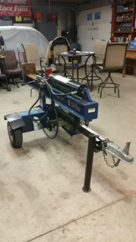

My Dad, Grandfather, and my self went in thirds and bought this splitter. We got a decent deal from a family member who works at an equipment dealer. They are getting out of home owner type rentals, and we got first dibs on this beauty. My grandfather really likes the idea of having the log cradle. I am a fabricator and can't see paying 100$+ for a new one.
The cradle seems straight forward and I was hoping someone could offer up a few pictures of theirs. I have no problem welding to the I beam but I would like to avoid it. I know the factory one says no drilling which I would like to reproduce this for ours.

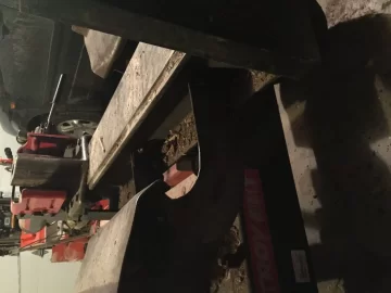

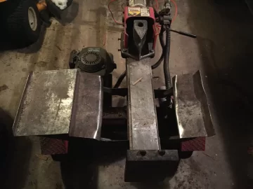

[Hearth.com] New (to me and family) Iron & Oak 26 Ton. [Hearth.com] New (to me and family) Iron & Oak 26 Ton. Good quality splitter you've got there. A 4 way would be nice for the easy to split stuff, but I normally end up with gnarly big stuff so I just have a regular wedge. Here's a couple pictures of my cradles on a 27 ton Troy-Bilt. Tabs were already welded on the sides of the beams and then these plates were fabricated and bolted to the plates. Mine go up above the beam because they would have hit the wheel/fender when vertical.

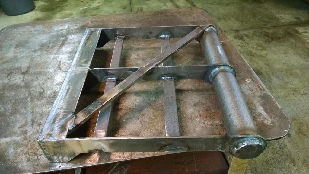

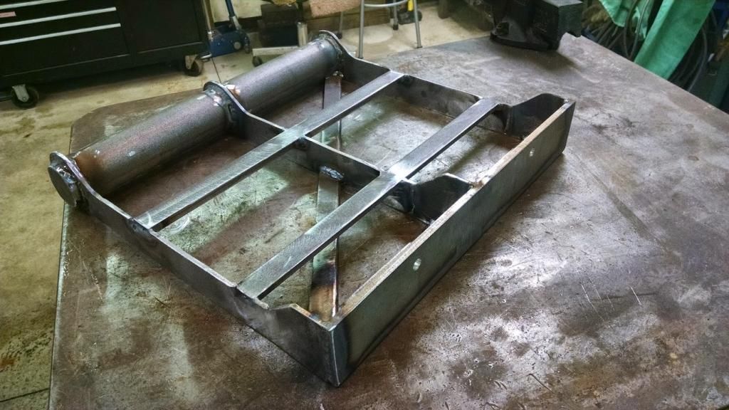

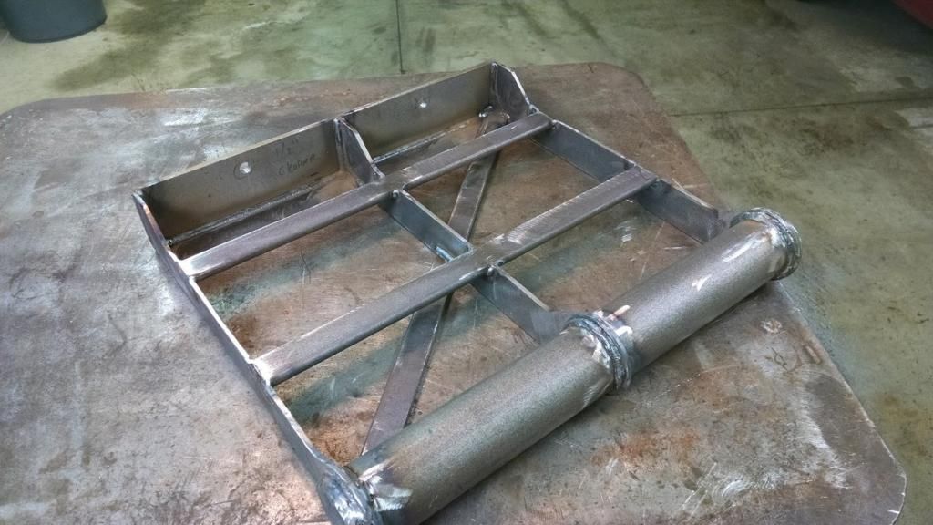

I had few hours to kill and made a log cradle, no pics of it on the splitter yet because its at my dads. Needs a coat of paint and its ready to go. It's overly complicated I know, but should do the trick. It will clear the tire when the splitter is used in the vertical position. Hopefully we won't be unbolting this thing for any reason.
