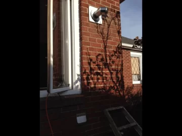

JUSt picked up an englander, heats 1500 square foot. Also my exhaust tip ends about 1 1/2 foot away from my outside brickwall, should I add a 12” vent or keep as is? Thanks
From your manual. you may have to render your window inoperable to meet code. That pipe is real close
VENT TERMINATION CLEARANCES
A) MIN. 4-FT CLEARANCE BELOW OR BESIDE ANY DOOR OR WINDOW THAT OPENS. B) MIN. 1-FT CLEARANCE ABOVE ANY DOOR OR WINDOW THAT OPENS.
C) MIN. 2-FT CLEARANCE FROM ANY ADJACENT BUILDING.
D) MIN. 7-FT CLEARANCE FROM ANY GRADE WHEN ADJACENT TO PUBLIC WALKWAYS.
E) MIN. 2-FT CLEARANCE ABOVE ANY GRASS, PLANTS, OR OTHER COMBUSTIBLE MATERIALS.
F) MIN. 3-FT CLEARANCE FROM A FORCED AIR INTAKE OF ANY APPLIANCE.
G) MIN. 2-FT CLEARANCE BELOW EAVES OR OVERHANG.
H) MIN. 1-FT CLEARANCE HORIZONTALLY FROM COMBUSTIBLE WALL.
I) VENTS INSTALLED WITH MECHANICAL EXHAUSTERS SHALL TERMINATE NOT LESS THAN 12 IN. (305MM) ABOVE THE HIGHEST POINT WHERE THEY PASS THROUGH THE ROOF SURFACE.
As long as the window remains closed. Code guy in my area would make you put screws in the window to make sure it is not able to open
