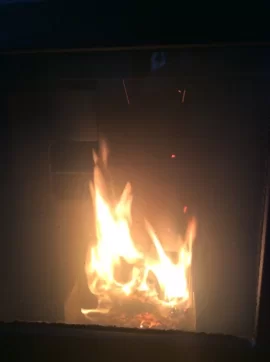

how does the fire look? yellow and busy or red/orange slow and lazy?
Heres what i was talking about and ssyko heres how the flame is burning

thats not a bad fire. It takes a little while for the stove to get up to temp and it is its first fire so don't get discouraged. your going to have to learn the stove settings to fine tune to your liking. now every time you change a setting it takes 30-40 min for the stove to adapt. its slow but you'll be happy when the bugs are worked out

Several things-1 you should have at least 3 foot vertical rise in your exhaust,per manual.2-you should have installed the parts for outside air,per manual, 3--MOST important--you are missing the impingement plate that covers the big hole behind the flames,will never get good heat without it.
yes that plate is imperative for heat..
