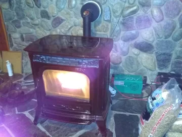

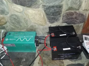

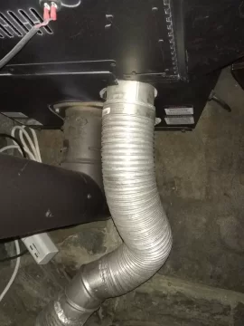

2nd the NG or Propane. I have similar sized house. For Backup I keep Inverter/Generator (AIMS 1250) with two 100ah Batteries for 12 hours of Run Time on Medium Fan speed and Manual Mode (No Shutdown & Restart). One time in 3 years went 10 hours and it worked great except I did not have 2 batteries. Had to get another battery from Garage to swap out. I have 7kw Genny if it goes longer and I need to charge the batteries. I plan on PSW Generator in the Future. I have Harmon XXV for heating when it goes below 30f (Heat Pump until then). Used 6 bags of pellets since Sep. Warm at Night still. It's 48k BTU. I would have got P63 but Wife wanted pretty one (Brown). I put Stub on the OAK so the OAK Soft Intake Tube don't get damaged each time it's cleaned. Plus exchanged the screws for panels with ones I can just twist off easily instead of screwdriver. Makes it easier to take off back panels and do the 1 Ton Cleaning. I have plenty of room to clean it. I use couple of Box Fans to move air down the hall. It keeps it about 65f in Winter. Plus Ceiling fan in Living Room. If you think you will need box fans get the yesterday. They disappear in Stores in Fall/Winter. I picked up Cougar ASH Vac on Ebay for 65 bucks. Had to replaced filters. Works great.

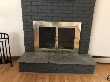

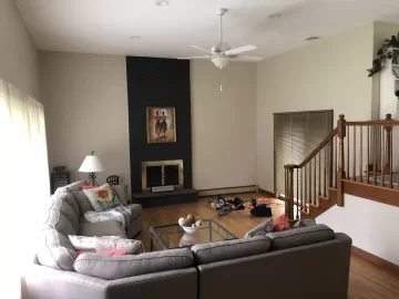

Fireplace is up 10” off the floor with an 18” hearth. Not big enough for a free standing unit plus aesthetically it would not be preferable. I know I’ll get a lot more heat than the traditional fireplace (which essentially is zero). I know it will take a bit to completely offset the cost. Wood insert is about $1000 cheaper but that’s no longer an option.

The website for that stove says it will heat a 2,800 sq ft house if the temperatures are mild. So I'm thinking it won't heat a 2,400 sq ft house if it's cold. Is the floorplan open? Looks like that is in kind of a den type area.
As the older guys keep repeating on here, a pellet stove is a space heater, so you'll heat the room the stove is in pretty well, and adjacent rooms OK, and other rooms or other floors not well at all. You'll lose a bunch of heat up those stairs, but not necessarily enough to keep whatever is up there warm.
A pellet stove gives you the look and feel of a wood stove, without all the labor of cutting and splitting and stacking firewood. You still have to carry the bags in there, and when cleaning it can be dusty and dirty. If it was my place, I would definitely put one in that spot, but its your money and your house...
