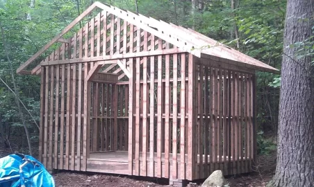

    Just built my first wood storage shed. Customer of mine asked me if my boys would take down there 22'x26' pressure treated deck and they would pay them. The condition of the wood was more than usable so I made sure they were careful taking it apart. I took 4 truckloads of 5/4"x4" Decking and 2"x8" joists to the house. Had a little spare time the last few days so we pulled a carp load of nails and started processing the 2x8's into 2x4's and there you have it. All free except now I have to purchase plywood and shingles. Oh ya, and the boys made $225. IMAG0173.jpg

    Thats nice, looks big too, how many cords can you fit in it?

    Sharp looking shed . . . are you planning on keeping the sides open to allow air flow? How beefy are the roof trusses -- or is snow load not as big a concern where you are located? I assume you also made to sure to beef up the base as a load of wood on a shed floor can be wicked heavy.

    Personally, if it were me, I'd put a roof on that shed and stop there. Leaving the sides open as they are will help the wood. It will also save you a couple dollars by not putting siding on.

    Thanks. Walls and gables are staying open. The floor is also vented 1-1/4" between Decking. The way I see it, the more the merrier when it comes to adequate air flow.

    When I get a little more time to tinker on it, I plan to truss the rafters as we normally (except this past winter) get quite a bit of snow here in New Hampshire. As for the floor it is friggen bionic. Triple 2x10's for rim joists, another triple 2x10 centered front to back and remainder of joists are 2x8's @ 16"o.c. I believe that if the cord wood were made of steel it would still carry the load. Haha.
