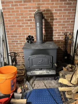

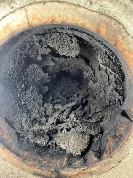

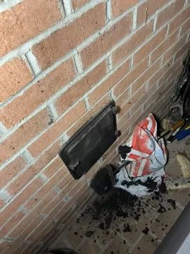

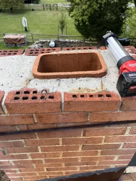

Hey guys,
I am new here and glad to be here. So for the past year or so I have been doing research and decided that I need to replace my wood stove. It is a Huntsman that is easily 35+ years old. So far I have been looking at units with cat systems. Specifically the Jotul F500 Oslo, Blaze King Princess or Ashford 30.2 and now even looking at stoves like the Vermont Castings Encore Flexburn. There are things I like and dislike about them all for instance, I have a lot of already cut firewood that is 20"+ and the Jotul mentioned can accommodate 24" logs but does not seem to have a cat bypass. Any feedback here would be good too, as I am not fully sold on a cat stove.
I also talked to someone from the Northline express website that sells Chimney liners. I am completely new to adding liners and was told that it would probably be a good decision regardless. Anyway she asked me to send some pictures and measurements over to their email and I already did. Hoping to be able to install the liner myself. I think I am leaning toward the "smooth" double wall one that will last longer and be easier to clean. Anyone else do this install themselves? Is it pretty straight forward?
If I had a question it would be am I going to have any kind of trouble getting fires going or keeping them going from what I am used to? I see so many horror stories, especially with new stoves and liners like having to replace cats, chimney liners and even stuff like having trouble with the fires. I realize with time one can learn all this stuff and doing it properly will produce great results. Having this in mind, I am looking at jumping into a stove with a cat system and installing a new liner all at once and I imagine it is going to be a considerable change for me. I am hoping it will be for the better. Just having that said, I want to cover my bases and avoid a horrible mistake and possibly freezing to death this Winter if I can. 😂
Another thing was my chimney flue seems to be perfectly straight and have no neck and very little or also no damper. I stuck a measuring tape in from the top and it easily made it to the very bottom where the ash cleanout is. By the way this outlet port between the wood stove pipe and chimney is like this every single year. I also have not had this chimney inspected in a very long time.

Ok a few things I see from your pics.
1. Your clay liner has a crack directly across from crock. On the left side. That means you need a liner.
2. You badly need a new crown ontop of the chimney
3. You will most likely need an oval liner inorder to fit insulation in your chimney.
Now as far as the liner type the 2 ply smooth wall stuff is absolutely the least durable option on the market. Go with midweight or heavy wall liner if you want an upgrade from the standard light wall. The 2 ply is a downgrade

1. You mean the visible crack near the top? It is slightly to the left. I wondered about it but it did not alarm me.
This is why I posted here, trying to learn. So what little I have researched I thought the double wall, smooth inside was the top of the line stuff? I realize this video is from over a decade ago but he recommended the double wall, smooth inside.
I am trying to find YouTube videos to shows how to install liners now. So far I have only seen ones that come down into a fireplace that makes it very simple. I am not going to have that luxury by any means. I am guessing things like the "T" connection are going to have to go down into the chimney at least partly assembled.
Yes that is the crack I am referring to. And seeing one there I can pretty much guarantee that there are more.
The 2 ply stuff is sold as top of the line by some companies. But in reality it really isn't durable at all.
And yes you will need to attach a tee body to the liner actually 2 in your case one for the thimble and one for the cleanout. A snout then slides through and attaches to it. And don't forget you want an insulated liner not just a bare stainless liner
