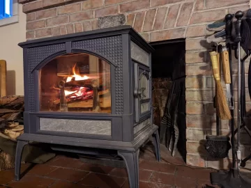

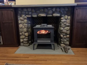

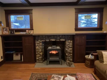

My new Woodstock Keystone is finally here, installed and running very well. Thanks to all those who gave me feedback on this stove and my installation over the past few years.
It runs very predictably and in a very well-controlled way. My installation is rear-vented into double-wall stove pipe with about a 2 foot horizontal run, then two forty five degree elbows to get to vertical, then a pipe damper, and a short vertical section connecting to double-wall chimney pipe (25' straight up). Of course, there is an insulated block-off plate. Combustion air is supplied from the outside. This installation is first-class compared to the previous home's installation.
I ran they Keystone a little conservatively for the first few fires until I understood how much the draft would impact the stove top temperature. Now, the procedure is pretty simple - 1) reload stove on coals, 2) let good flames get going in the firebox and shut the bypass, 3) at 250 degrees F stovetop, shut the air down to 1, 4) close the pipe damper at 400 degrees F. Cat lights off predictably when I shut the air down to one, stove top temp climbs very gradually from 400 degrees (after I close the pipe damper) to 550 or 600 degrees (depending on load) over a period of two or so hours and remains there for two or so hours before starting to fall back. With a full load of wood, I'll get some nice secondary combustion for a couple of hours once the stove top hits 500 degrees or so, and that is a nice bonus to see that secondary combustion (I enjoyed that on my previous tube stove). I have good quantities of coals to relight after 12 hours of burning (and a 250 degree stove top temperature) as long it's not a partial load or an all cherry load. In short, this stove is everything that everyone described to me, and I am very pleased with it. It doesn't overheat my 1750 square foot well-insulated cold-climate house during a 12 hour burn.
I do have a couple of questions for those with this stove:
  1. During the first couple of burns, I had some backpuffing (explosive light off of combustion gases) that would result in smoke leakage at the seams. I don't have this now. Is this normal for this stove until the seams seal during the first couple of fires? I think I have the startup and burning process figured out so I also really don't get the backpuffing now, but once in a while I do but I don't have smoke leakage anymore.
  2. I still (after about 10 or so burns) have that hot cast iron smell after the stove top heats up to 500 degrees or more. Its less noticeable now than it was initially, but I can still smell it if I come in from the outside. My house is very tightly constructed (with an HRV). Is this normal with a cast iron stoveand/or will this go away after a while? I know it is the cast iron (not the paint) because it smells just like if I heat an empty cast iron pan on my kitchen range.
  3. Is 600 degree stove top what you see on this stove at the peak of the burn cycle?
  4. I've got a thicker coating of residue on the bottom half of the glass (conveniently behind the andirons, argh) - the top half seems to self clean pretty well with the secondary combustion. This happened during the first two or three burns as I was figuring out the stove. Once I clean that off, will that stay clean or will that residue reappear? Or should I just wait for a bunch of fires to take care of itself?
FYI, the ordering, delivery and customer service process was very smooth - placed my order in April or so and was told probably September delivery, then it became early November, then late November - all ok, I get that they are busy and also likely dealing with supply chain issues. Everyone at Woodstock was super helpful and easy to work with. Stove arrived uneventfully and undamaged.
Lastly, I can't imagine fussing with a tube stove again after having this stove. The two different tube stoves I had were well-constructed, good stoves. But the amount of control and lack of babysitting needed to get a good, clean sustained burn on the Keystone is way less than on the two Lopi stoves I ran (and I think this is true for any tube stove, not just a Lopi). And the Keystone does a great job of moderating the strong chimney draft as well.
[Hearth.com] New Woodstock Keystone install [Hearth.com] New Woodstock Keystone install
Very nice. I had a fireview. Woodstock makes top notch stoves.
Nice looking install! I burned a Keystone for many years, it’s a great little stove. I had an occasional back puff during certain weather conditions or when I turned it down too low too fast. The smell is probably just breaking in a new stove. As it gets hotter and hotter you may have some smell til she’s broke in well. I think the glass will clear up with hotter fires. Lower burns below 1 will do that. I mostly ran mine around #1, a bit above when I needed more heat or a bit below for less heat and long burns.
Nice to hear a positive new stove story! Sounds as if you have covered the basic operation safely. Now the fine tune will come in time. Congrats.
And coming from a twice over tube stove owner/operator to boot;)
Nice contribution. Enjoy
The stove looks great in that setting. I've always liked the Palladian and Keystone. It's good to hear that it's working out well for you.
Very nice!
Before I actually clicked on the second pic and blew it up I thought the two windows were his n hers tvs! ;lol
They're Marvin's tvs. ;lol

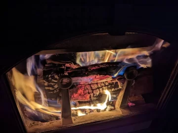

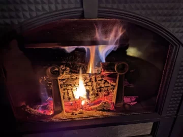

Well, DBoon, you got me to clean my glass. 😏 Fire was pretty much out, so I did it. BTW. what color is your stove, the metallic blue? Mine is, and it's more gray than blue...I like it.
It wasn't cold in the house but I had to fire up a short load to look at the clean glass. 😄
I did a top-down start and left a little space between the front log and the second, and was able to get a burn with flame in the front, and in the middle. When I cut the air and the fire got lazy, I got some cool intermittent, gentle flashovers across the bottom of the cat scoop.
The cat wasn't glowing very bright since the flames were burning some of the smoke. I didn't help seeing the cat in the pic, when I forgot to brush off the cat scoop screen after I got done with the glass. DOH!!

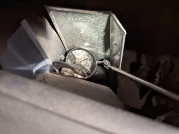

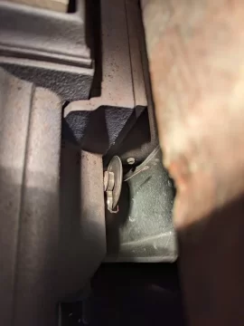

Yes, you can sometimes blow smoke through the cat too fast and it won't get burned. I haven't quite figured that aspect out yet. Sometimes I can run flame and be fine, other times smoke gets through. When it's light out and I can see the stack, a lot of times I'm just gliding on coals, and don't fire a load until it cools down later in the day...and it may be dark so I don't get to see if I'm burning clean. Then again if the wind is right and the exhaust gets blown down, I can tell if it's smoky. I don't think my wood floor in front of the stove gets very hot but I'll check next time the cat is blazing. Or did you have flame in the box at the time as well? I, too, think that an occasion split that got rained on can affect how quick you can get the cat glowing, and how clear the glass stays as well. But I'm not going to burn a big flame and send BTUs outside, just to clean off the glass. It clears to some degree when I burn in the next load, and that's good enough for me.Usually the middle third stays pretty clear, side thirds may also be clear, or maybe a bit darker, depending on those factors. I'm not sure how clean these cat stoves actually are in real-world burning, vs. the EPA test burn. When cruising with the wood smoldering, creo builds up in the box. Then when you reload and fire it for a while with the bypass open, you can smell some of that stuff burning off and going straight out the bypass. There's a hole on the back of the stove, above the air control lever. You can see the probe dial on mine, with a paper clip marking 1000* since the back of my stove is flush with the masonry fireplace opening and it would be hard to see without a mirror. But you need a probe about 8" long so the cat temp is diluted, and what shows up on the dial is basically the temp at the flue collar. That is useful, but pretty much runs parallel to the reaction of the surface meter that I have lying on the tee snout, about 6" back of the flue collar. I'll get an Auber probe or something in there at some point, and the transmission line may be insulated and give a true cat temp reading...?

Re: the smoke through the cat, yes, it has happened with flames in the firebox and >600 stove top temperatures. I think that more aggressive shutdown earlier is the key, and I'm getting better at that.
Re: the cat probe, I'll try to find that access point during my next shutdown. Realistically though, that location won't be too convenient for me to look at given my slightly recessed installation. No big deal though - the stove operates very consistently and I haven't felt the need for the cat probe, or even a flue temp probe for that matter.

I remembered I had a 2" mirror on a telescoping rod, so until I get a digital cat probe installed I'm using the analog Condar probe to track temps around the flue exit. My probe is 8" but since it's only reporting flue exit temp and not real cat temp, you could just use a shorter analog probe there.
The back of the stove is flush with the fireplace opening, and the mirror makes it easy to read the probe dial, which faces back into the fireplace. I also have the rear heat shield installed to keep heat from radiating into the external fireplace masonry and exiting the house. Keeps the stove hotter, I think. The mirror can easily slip between the probe dial and rear heat shield. You can see the paperclip marker (and its shadow) that I was using, before I thought of using the little mirror. I guess I could get rid of that now.
