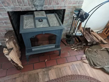

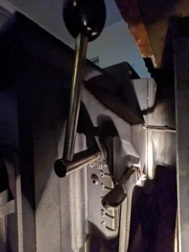

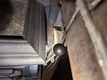

Stove is rear-vented into the masonry fireplace, into a tee, then liner on up.
The hole on mine is about even with the center line of the rear flue exit, in the back of the air lever/bypass lever housing right below where it goes from sloping to vertical, about an inch out from the edge of the flue collar.

Very interesting - no hole there for me (unless I am just blind to it, or maybe it is just hidden too well under the rear heat shield. I'll have to call Woodstock one of these days and ask them where to find it.
