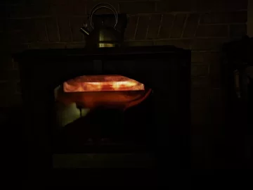

I don’t think those probe temps are accurate, seem low. You will see more much faster accurate cat temps with that AT200.
For sure. I know from the Buck 91 and the Dutchwest that when the cat is glowing in a similar manner, that's 1200* or higher probably.I don’t think those probe temps are accurate, seem low.

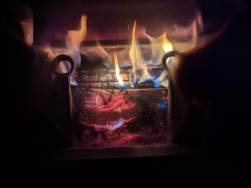

It sounds crazy, but that is the perfect burn in my situation. It's burning really clean (no smoke) as it's rising from 250 to 400 over a period of a couple of hours, so I can't complain. If its really cold outside, I'd prefer to have more heat, but I love the steadiness of the burn and slowing down the initial burn to keep it slightly less hot at the peak.It appears you might be rushing the bypass closing, and don't have enough wood burning yet to feed it. It was a couple hours before you got to 400 stove top.

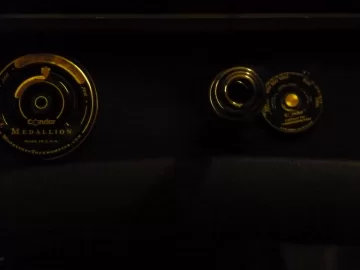

Yes, I got the magnet over the ash pan hole at times as well. I've put it over the hole when it was below zero outside. That seemed to slow it down a little more, and was helpful. But I've found with my chimney the glass stays cleaner if I just shut the air down to 0.0 and leave the ash pan hole uncovered.Forgot the pic of the ashpan housing magnet previously covering half the grate airfeed hole.

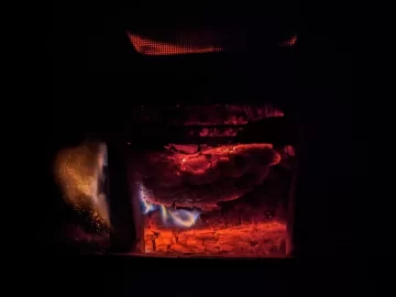

My glass has been staying clearer since I've run a bit more flame in the box lately, after the cat is lit. Not a lot of flame but apparently enough to just have haze. The left side is a little worse, since I had an air leak on the front left vertical seam which I didn't get completely sealed apparently.not going to burn a big flame and send BTUs outside, just to clean off the glass. It clears to some degree when I burn in the next load, and that's good enough for me.Usually the middle third stays pretty clear,

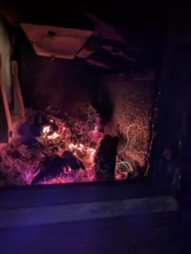

Yep, sometimes you can see a little flame coming forward from underneath the load, from ashpan hole air. I'd think that puts a little more heat on the bottom of the glass and maybe keeping it clearer...?I've found with my chimney the glass stays cleaner if I just shut the air down to 0.0 and leave the ash pan hole uncovered.

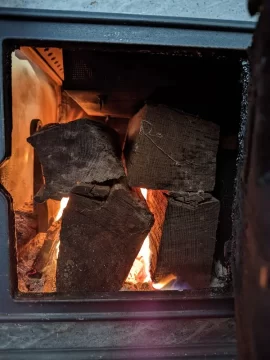

For sure could probably get the air lower, sooner, but erred on the side of caution after overdoing it in the last White Oak burn, and having to open the air back up. I usually burn mixed loads, these are the first all-White Oak loads I've done but I'm more confident now that it's easier to get the White burning than, say, Black Locust.your startup sequence above is pretty similar to mine. Try being even a little more aggressive on slowing down the burn early, especially if you have a nice deep coal bed and are starting with a 250 degree stove top. I've stretched the time to go from 350 to 470 degrees stovetop to two hours or so, and while that reduces the peak temperature and length of peak burn time, it's a great tradeoff. Also, my burn is clean during the whole start up cycle - that cat is doing its job and just chewing through the smoke and the exhaust is nice and clean.
