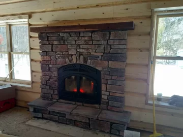

Building a new home(log cabin) fireplace was completed today, thought I'd share. Heat N Glo Northstar.

Very nice job there...and the housewarming party is when? ;)

Very nice! Would you mind sharing the details of your stone? Is it cultured or natural? Thanks!

Wow - your Northstar looks fantastic!!! Great work!
How are you liking it so far? How is the heat output?

Have been using it to heat all this week. It was below 10 above zero last couple of mornings, and there is no insulation in roof at this time, we are currently putting in the tongue and groove ceiling so it can be insulated. The stove is doing a nice job, this afternoon we worked in shirtsleeves inside and it was really cranking out the heat. Once insulation is in I'm pretty sure we will not use much propane in the forced air system!

My brother has had that fireplace for five or six years now and really likes it. He has a huge great room and when that things really cooking he needs to crack a window even when it's very cold out. Very capable heater. Your install looks great.

Did you use the SL-300 or Duravent insulated pipe?
