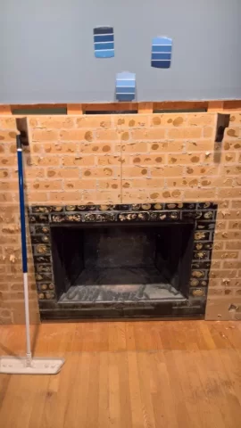

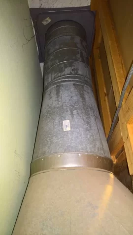

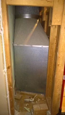

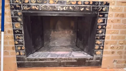

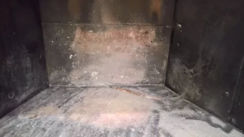

So my house has an existing ZC prefab fireplace(not sure on the model, 36" wide box). When we moved in it didn't even have doors. Just a screen and some electrical running into the box(must have been a blower at one point). Picture is attached.
So we are now remodeling the walls around the fireplace and would like to actually have a fireplace that will heat our house instead of cool it. I got a quote from a local dealer for a Fireplace X Elite 33 insert for $5K which is way more than I want to spend. Now that I have the sidewalls removed and see how simple of a deal these fireplaces are I am wondering if it would be better and cheaper to just remove this fireplace completely and put a new EPA fireplace in. Can I do this myself? The only thing I am wondering if is if I can run the new chimney down the existing one or if I have to completely remove it and put a new one in. The existing chimney is 12" in diameter.
I have posted pics of the front and the sides of the existing fireplace since I have the whole thing wide open rght now.
Thanks in advance for your advice.
Yes that is your best option and that is what the dealer was suggesting as well the Fireplace X Elite 33 is a zc stove. And yes you could probably do the install yourself

There are some complete install threads here. You could DIY if you follow directions and measure well. The install manuals are usually pretty good, just don't rush it. The new chimney will likely be 6 or 8" class A pipe which will be smaller diameter than the current 12" pipe. That may mean some changes up topside to ensure weather tightness.
