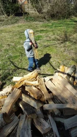

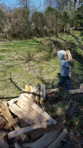

Well, took the plunge and got a cord of wood. Had to re-stack it as the guy tried to go down the middle of the pallet. Nice windy spot with morning sun on one side and evening sun on the other! Also, fun with my helper! [Hearth.com] Newbie Assistance/Advice Requested[Hearth.com] Newbie Assistance/Advice Requested[Hearth.com] Newbie Assistance/Advice Requested[Hearth.com] Newbie Assistance/Advice Requested

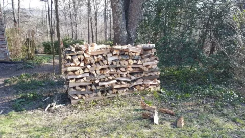

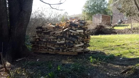

What are the dimensions of that pallet???
Nice start !
Yes at least 3. I'd double it, and get ahead.
8ft x 34"ish. The rebar is marked with tape at 4ft from the top of the pallet to make it easy.
Test passed... almost a cord, give or take, with the height :)

Yeah, I think the guy was a bit surprised that I had a pallet all ready to go and sized - he did ask about the length of the pallet...
Good thinking getting a start on the wood, what length are the splits?
They vary, he brought two loads. First load averaged 16-18. Second load was closer to ten to 12. I'm fine with that, though likely try another local next time around.
