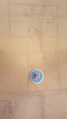

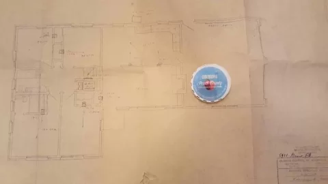

How's the house layout? Even a rough sketched floor plan would help, also.

[Hearth.com] Newbie Assistance/Advice Requested
The current fireplace is immediately to the left of the cider boys cap. Where the cap is, would be my garage. Garage feeds into kitchen, then dining area, wall between kitchen and living room, fireplace. On the west side of the plans the house is a split level. Downstairs there's a large unfinished room we use for storage (door always closed), large room we'll eventually carpet for the kids to play in, and a laundry room. Upstairs we have 4x bedrooms, two bathrooms. Master bedroom in southwest corner of plans.
Hope that all makes sense!
Fixed it for ya .... my new glasses won't be in until next week ;)
Is the wall full between the kitchen & living rooms?

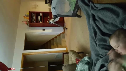

There is a door on the downstairs side we installed so children wouldn't go falling down them. Usually open since the main air return is right there. Upstairs side is open and no doors. [Hearth.com] Newbie Assistance/Advice Requested - sorry, haven't figured out how to rotate images for posting on tapatalk...
Is OK, I've fixed many a photo here :)
Do you have a ceiling fan upstairs?
And what's going to heat the lower level?
Three ceiling fans upstairs (master bedroom and children's rooms). Downstairs is mostly unused for now aside from storage, an elliptical, and the laundry room.
You won't want to put the stove in the basement. Not enough air movement to get the heat upstairs!
