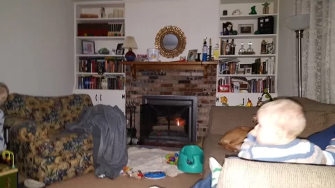

My wife and I purchased a new home about a year and a half ago. The house was originally built in 1959 and much of the original fixtures are in place. We've been slowly upgrading things (more inflation (r-60), updated kitchen, paint) while jugging two infants.
This year, I wanted to get a new top mount chimney damper (9x13 chimney, no damper installed, masonry). When I had someone come out to check out what it would run, I discovered the previous owners had installed a rather odd chimney cap (there are cinder blocks with bricks mortared around it). My quote for demo/rebuilding/capping/etc... plus the new damper would run ~$1200.

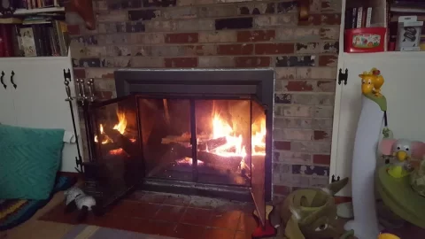

Current fireplace dimensions measure 37.5w x 31h x x17d (see pic). [Hearth.com] Newbie Assistance/Advice Requested That measurement is taken to the outside of the metal frame as I'm pretty sure it will come off fairly easily.

Looks to me like it will just barely fit in your situation but more knowledgeable folks will need to better assist you.
Bob
I agree. Pictures can be deceiving but it looks tight from how I see it. You may be shocked at how much room you will lose to a stove compared to an insert. There was a post a few days ago from someone removing their stove and putting in mini splits because the stove took up too much space in their living room. Having small kids will add to the space problem because you need to fence off the area until you are positive they understand the dangers.
What I would do is measured out the total area your potential stove will take and set some chairs or table in that spot. Then look and see if that works.
Personally, of look to see if an wood insert will perform in your dimensions.

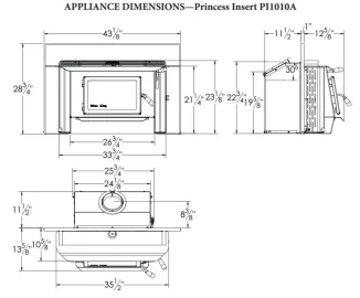

Don't confuse a fireplace with a stove insert- you can put a real stove into the fireplace.
You will get better performance from a freestanding model than an insert, but that doesn't really look ideal for your setup to me. I like DougA's idea of marking off the floor and hearth space required with tape or furniture and seeing what you think.
I heat a slightly larger area with a Blaze King Princess insert (although I wanted a freestanding stove, the insert didn't require any remodeling, and we didn't lose any of the floor space in the room), and it works very nicely.

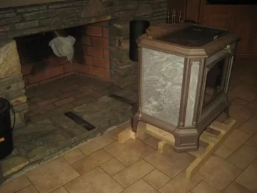

Looks like my stove would fit your fireplace, too.
That might be a great solution - especially since I'd discounted the Blaze Kings in general since they require a top mount exhaust.

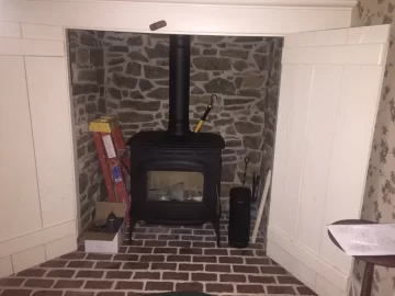

I have the progress hybrid with a set up like you have. I used to have the princess insert and it was OK but get much more heat with the PH. Off the top of my head I'm not sure what the distance requirements are but can check the Manual for you when I'm home later tonight. You can't go wrong with either stove.
Forgot to add I have the short leg kit and have the stove set into the fireplace 2-3 inches so it only sticks out 22 inches and is not in the way at all.

By chance, do you have a picture of your setup? Curious...

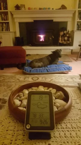

My wife had the same thoughts. However she ended up liking the look of the insert. It dressed up the hearth.

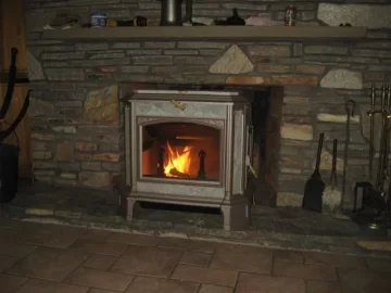

My stove insert is a quadrafire 3100i and I love it. I'm only heating my living room and kitchen which are one big open area and the main living area bathroom. ( leave the door open to bathroom or else it gets cold in that room) Roughly 1100 to 1200 sq feet of area being heated best guess. Works perfect for that space.
Could never heat the entire house with mine but I didn't want it for that. I use it in the evenings and weekends. Actually it hardly ever goes out but I need to turn the heat on the furnace when it's time for bed as the insert does not give enough heat to thoroughly heat the bedroom. Some heat makes it to the bedroom from the insert but not enough to be warm where I'm at.
That is one helluva nice stove! How much of a beast to get into the fireplace space was it?
Thanks, wasn't too bad, me and my brother slid it in, I used some sheet metal slabs to slide the stove. It was easier than I thought.

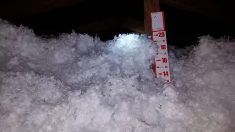

R 60! Good Lord! I just built an addition to my house and I exceeded the code, with R40.
You are the man! Is it fiberglass insulation, or what. Hell fiberglass would need to be 18 inches thick to get that spec.
Here's what I'm thinking (budget in mind) your going to want an insulated liner to be ran in that chimney, do skimp $$ on the liner, the chimney is the engine that drives the stove.
After the liner is installed, squeeze a NC30 in there, build a block off plate and your good to go. I like the NC30 for this because its a cost efficient good starter stove that will last years / decades, its a long more narrow stove so it can be pushed further into the fireplace for a liner hook up. That's my 2 cents.. let us know what you end up doing.
yes to fiberglass! Here's a pic from just before they finished.... [Hearth.com] Newbie Assistance/Advice Requested
