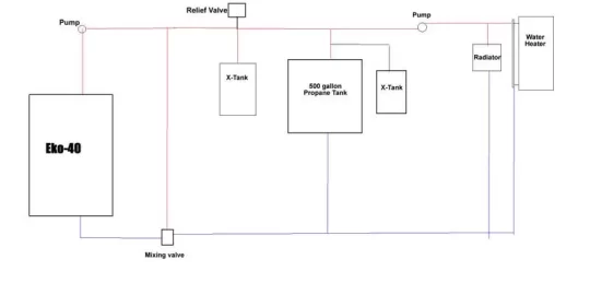

Most people these days use pex for the long runs, copper or black iron for the connections to the boiler, heat exchangers, etc. Black iron is better (and cheaper) right at the boiler. Some people aren't sold on pex, but it works well if you don't let your boiler overheat.
The EKO has 2" connections, but they are threaded different than standard 2" fittings, so you might want adapters, which I think run about $35 for the pair. Actually, I wasn't aware that the threads were different and so I just spun regular 2" reducers to my EKO. They leaked slightly until the boiler got up to temp for the first time, and they've been dry ever since. Since it worked, if I had it to do over again, I'd probably save the $35 and do it the same way again (though I'd probably feel guilty about it; ignorance is bliss).

Forgot to add in the very frumpy diagram for what I had in mind for my system. This system will be installed separate from a forced air propane furnace. Everything will be installed in the basement in the same room except for the propane tank which will reside in the garage.
Eric, so the run to the propane tank might be a good candidate for pex?
I should have titled this thread "help me design my system". :)
