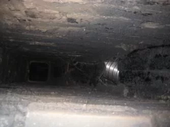

On sept 26th I asked the question "how do I convince the wife to let me get a fireplace insert?" Then I took a digital pic up chimney. At that point it was a safety issue as you can see.
I now have a regency I1200 which may fit your app as well. I'm not suggesting you show her the pic of my chimney and say its yours but you could show her a worst case scenario.
BTW I hate the yankees
I think her response would be "let's just get it swept then." I will take a pic however when I get home as I am curious.
