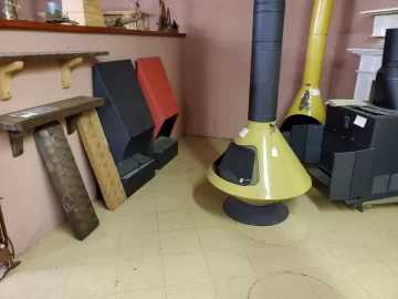

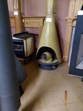

And just to prove that old stock is being liquidated, here are some very old retro images a dealer found in his warehouse.
[Hearth.com] Newbie looking for advice[Hearth.com] Newbie looking for advice
Reactions: jetsam and SpaceBus
Those stoves are a blast from the past! So cool to see something old in new condition. Thanks for that advice, I will make sure to ask the dealer about Step 1 stoves for sale.

And just to prove that old stock is being liquidated, here are some very old retro images a dealer found in his warehouse. View attachment 256689View attachment 256690
I like to think that at no point in my life would I have ever said, "Hey, a sheet metal open fireplace, what a great idea!" ;lol
At first glance I thought that the yellow elbow sitting in the firebox in that one photo was part of the unit, which was even more alarming .
