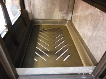

[Hearth.com] Newbie-- Looking for big glass & warmth for 2700 sq ft home Nice big full floor ash grate

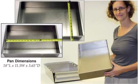

That is a big pan!
You get a lid too, which can be inserted onto the pan before you take the ash pan out so no mess, and you can do like I and many others have done and order a second pan from Woodstock so you can just swap pans out instantly, and take your time dumping the full one. Both pan and lid are stainless steel so no worry about rusting.

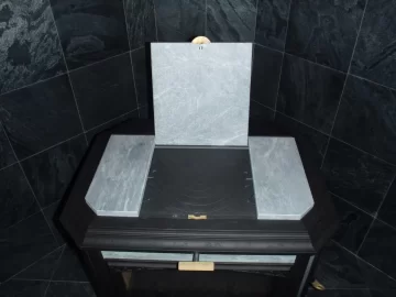

I like also how the stone on the top flips up (or removes entirely) to reveal the cooktop. The inevitable splatters and stains get covered back up by the nice looking soaptstone. I have lots of little splatters on top of my painted steel stove.

Wow thank you for all the photos!!!!!! That is great! Yes I love love love that grate and the ashpan.

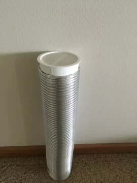

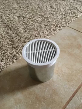

We were thinking to use this and paint top white part black:
  • [Hearth.com] Newbie-- Looking for big glass & warmth for 2700 sq ft home
Connecting it like this to crawl space under house (it's vented under house to crawl space)
Yeah good point bcrtops. Not sure which way is the right way. But if we installed what we plan to install I think this should be close to code?
I don't really want to use a huge register because then it's more drafty.
Not sure if we are thinking right or not.
