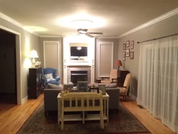

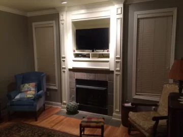

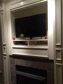

Newbie here, I have been lurking and trying to get up to speed on Zero Clearance fireplaces. My wife and I live in the North GA mountains in a 3 floor home ~4000 sq ft (that includes a finished basement). The house has three exterior heat pump/ac units, one for each floor. The people who built the house installed a gas fireplace, which was never connected to gas. So, it's been sitting there wasting space. There is I guess what you would call a false chimney, which is shrouded at the very top. I will take some pics later and append them to this post for further clarity.
Anyway, we are looking to pull out the unused gas firebox & gas logs and replace it with a zero clearance wood fireplace. Then have a flue dropped down the false chimney and connected to the fireplace.

At 5.5K total you are indeed looking at the budget end of ZC fireplaces. The KozyHeat may already be out of your price range unless you are willing to do some of the work yourself. Is there actually a chase with chimney above the fireplace or is it a direct-vent unit?
Have you thought about making an alcove with a nice hearth and placing a freestanding stove in there? That would fit better within your budget.
