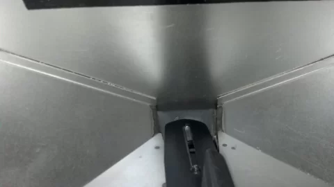

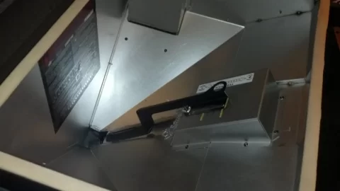

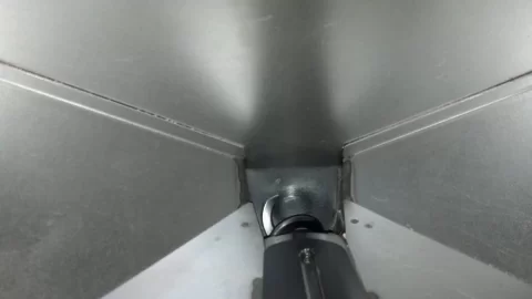

Case in point. You can clearly see that there is ZERO obstruction when full open. Please reinstall that gate. It is a needed component to control the stove (the Only one on a Quad/ no damper, no trims, etc)
This is UP.
[Hearth.com] Newbie Quadrafire Sante Fe user needs help getting heat
This is DOWN.
Up again, from another angle.
By the 'dealer' taking the feed gate COMPLETELY OUT, he has taken away your ONLY adjustment!!!! When you get various size pellets and densities, you will have no way to keep the flame height at the correct height! That was very stupid of him! IMHO, of course
